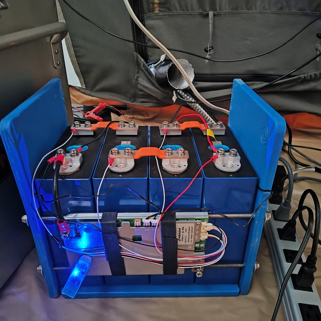

That would be sweet for redundancy. I at first charged it with jumper cables and then moved away from using the vehicle at all. The best setup for me is a generator and a battery pack. I'm working on a DIY battery pack. Its a lot more of a never ending project than anything else. Its 12V and 304 AH with a bluetooth battery management system.

A 304Ah Lifepo4 battery setup is pretty cool, unfortunately the Triaxide setup won't work with it. You'll want a DC to DC charger with a lithium profile to properly charge it. I have a Redarc BCDC1225D with solar input to keep my secondary fully charged at all times and I love that thing.
