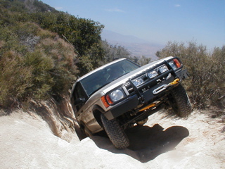

Encloseing a picture of my 99.
3" OME lift with 2" RTE spacers for the rear.
265/75/16 BFG MT's and way too much more.
Have fun shopping.
Mike J.

Don't mean to hijack but Mike, do you think you would have made that obstacle without your rear locker or etc?
D
discomike
Guest
Because I was slightly off line I slipped the r/r into a hole that needed the Detroits help for sure. I could have back out of it and driven up higher up on the ledge, would have kept me alot more level, but what sort of fun would that be.
It was pretty neat to watch both the front tires grabbing at anything with the TT's working but it was the Detroit that came thru.
I love finding angles and twists on a trail to play in.
Mike J.

Mike what kind of brushguard is that, custom ARB?

That is a bumper that I had made for me here in Santa Barbara not a brush guard.
