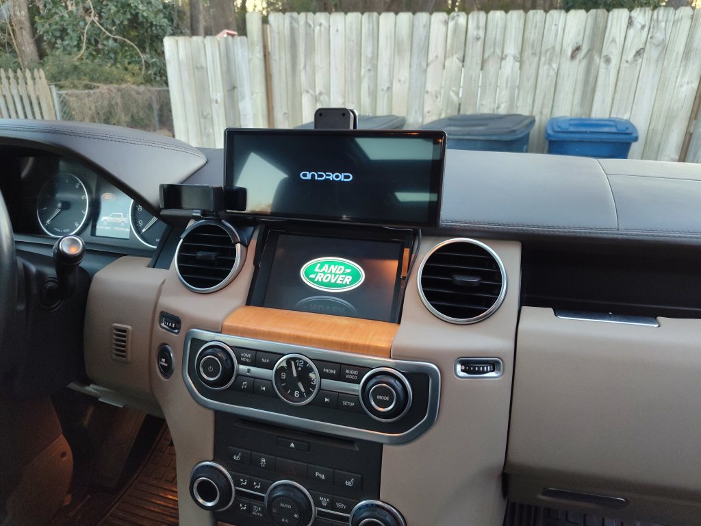

I just got a Carplay screen of AMZ in the 10.2 size discussed above. It had a $20 off coupon was was $70 delivered so I figured I'd try it. Preliminarily it seems OK. The thing I wanted to understand was the audio. So unfortunately to have the CarPlay audio go through the truck's speakers, I have to switch the audio system to Bluetooth Mode to get audio for reading texts, and that kind of thing. If I'm on Satellite, then obviously there's no way to hear the Map prompts etc. Anyway, it's kinda cool. Time will tell if I use it much.

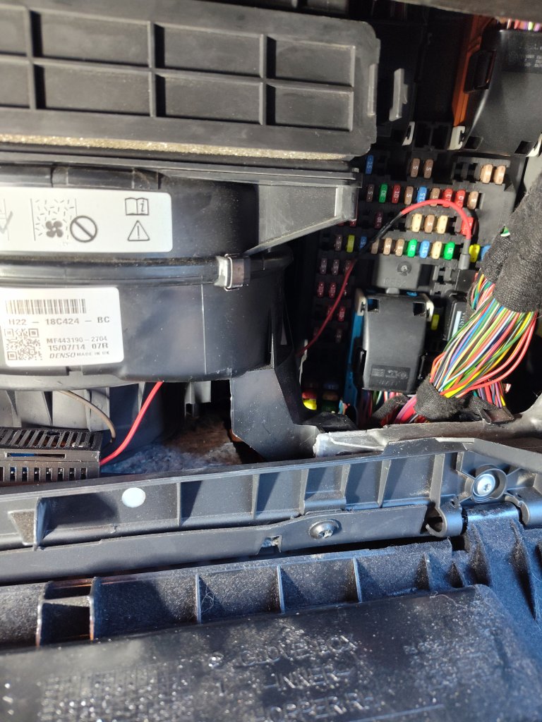

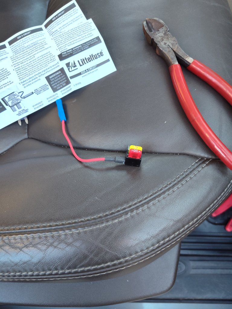

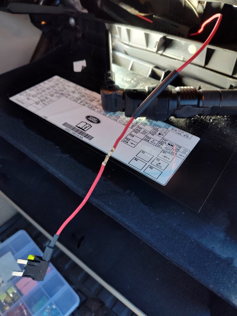

I wired it into the "cigar lighter" fuse using an add-a-fuse. I hate the junk blue crimp connectors that come with them, so I use nice copper crimp connectors and heat shrink.
View attachment 25586 View attachment 25587

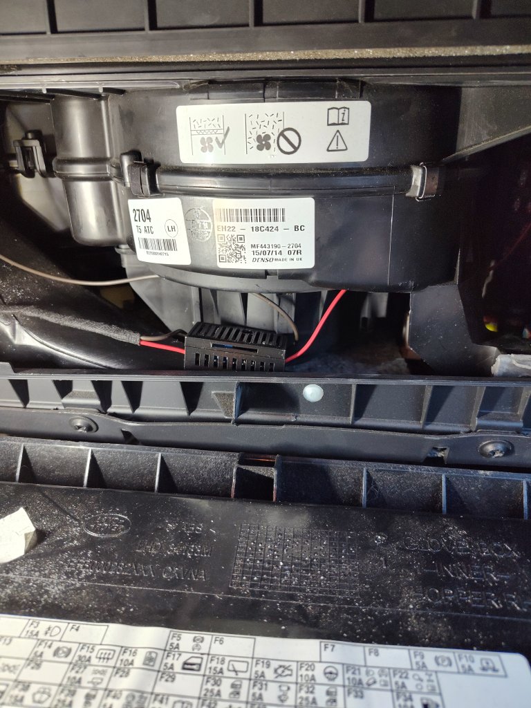

The "Cigar Lighter" circuit comes on with your interior lights when you unlock the doors. The Android unit takes some time to boot up so having it come on as soon as the doors unlock instead of waiting for the ignition seems to work well. Downside is it also stays on until your dome lights go off when you shut the truck down. If you want it to come on with the ignition, I'd add the fuse tap to the "cooler box" circuit if equipped. I found that it only comes on when the ignition switch is on. Here it is all connected:
View attachment 25588View attachment 25589View attachment 25590
NM. I found the ground trees on lower passenger side column under lower right trim panel in passenger footwell. ✅
I’ve got my screen in and ready to tackle hardwiring, but where behind the glove box did you find a ground to connect to? I’ve got my converter, add a fuse and stuff ready, but when I poked around back there I didn’t see an easy ground anywhere for the negative coming off the factory screen cable.
