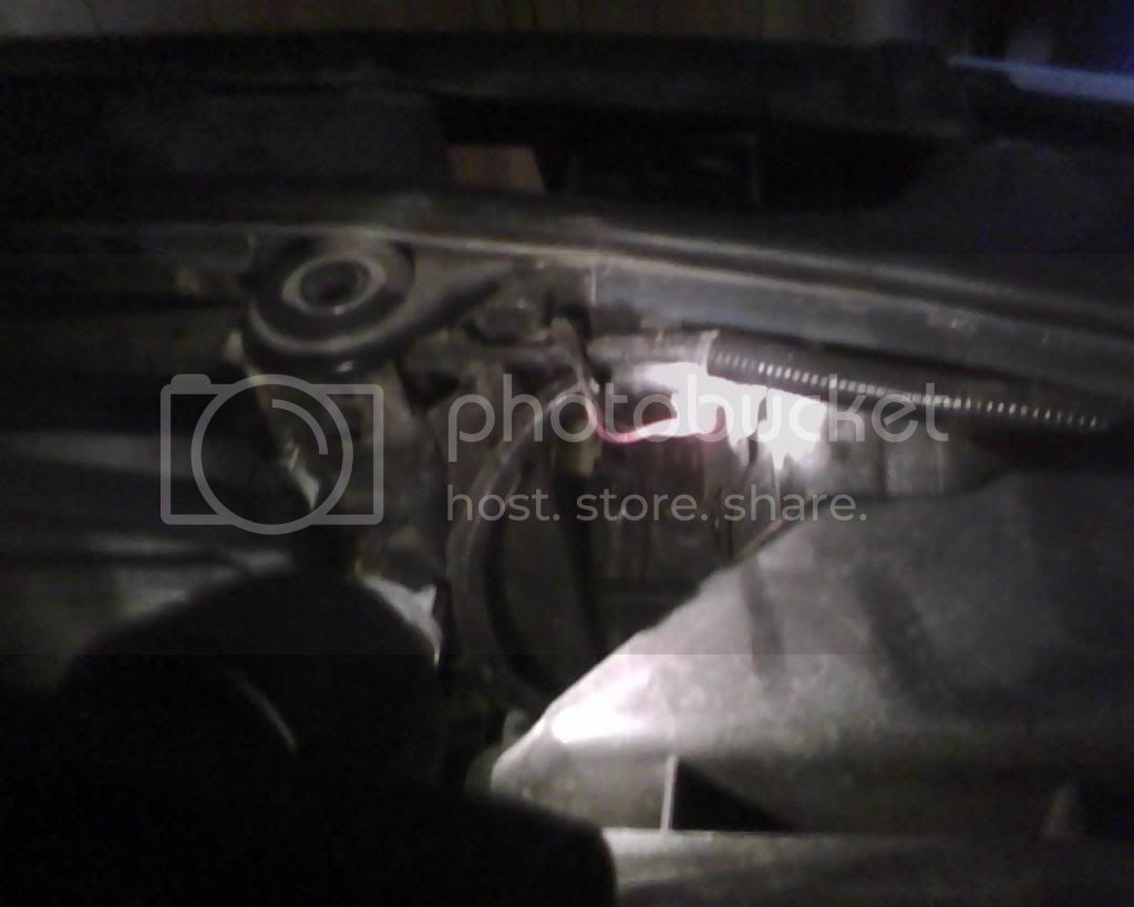

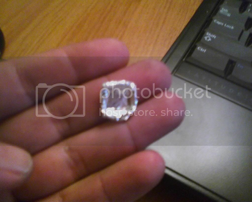

I also had the 'bonnet open' msg and the alarm would go off whenever I locked the Rover. Thanks to the members here, it took me 5 min to unplug bonnet switch and add a piece of foil and the 'bonnet open' msg was gone.
Standing next to the fender, taking picture toward the front. The switch is underneath the left side,passenger side, hood latch (standing in front of Rover). Unplug the latch where the thin wire are and the flashlight is hitting.
Then add a piece of foil and you're done. It worked for me. No more 'bonnet open' msg.

Assume foil sits on top of the spring?
I appreciate your efforts re the pictures and the solution.
I assume that the piece of foil sits on top of the brass spring metal to create a bit more height? It would seem that the brass spring looses its spring and hence will not push down enough on the micro switch contact below.
If so, probably the spring will in time get more tired and hence after a while relax so a second layer of foil will be needed.
I only hope that where owners are installing replacement switches that the newer models have a spring with a bit more life in them - like say 15 years.
