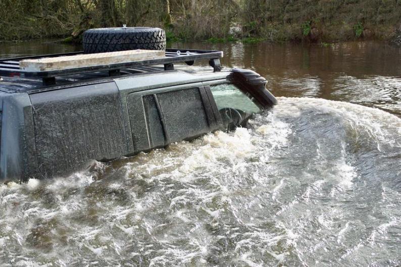

I think Houm is to be listened to; I expect the jpg below is just prior to total shutdown and filling up of the interior - probably not the sort of thing on road insurance covers.
The heater/AC air intake just under the right side of the cowl is big enough will let fish and frogs in as well as water. I doubt the pollen filter is designed to catch that sort of thing.
The name "raised air intake" is a hint and is called that for a reason; a snorkel it is not. It is good for dust and water splashes but water depths above the wheel wells is to be avoided.
In that depth of water, you would be wishing your 3 weighed more than 3 tonne; at some point, a box of air floats and traction is reduced.
