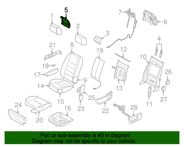

Mine are peeling badly and I want to either replace or refinish. The part # is LR032731 and they go for ~$140 a piece!
I gently pried on mine a few times and felt like the pressure was becoming too great and something was going to snap. Anyone that can advise on a trick to get it off?

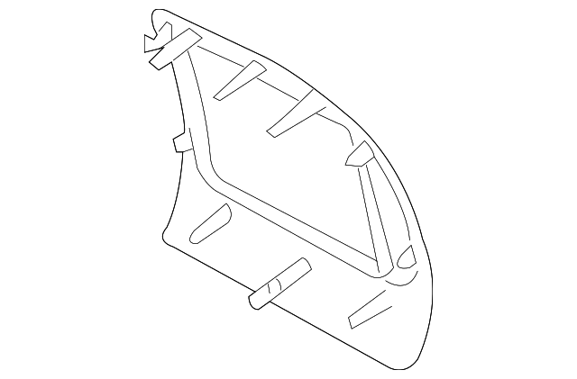

manual shows 10 pressure fit clips around perimeter of the bezel. no special trick ro remove. use a trim pry tool.
