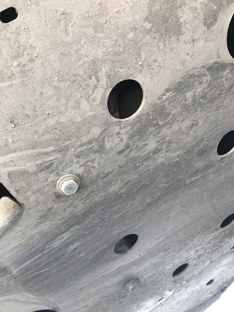

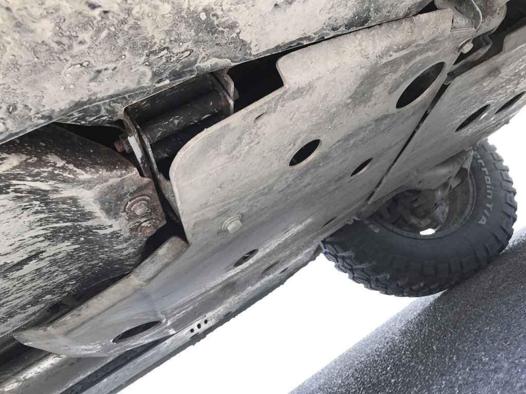

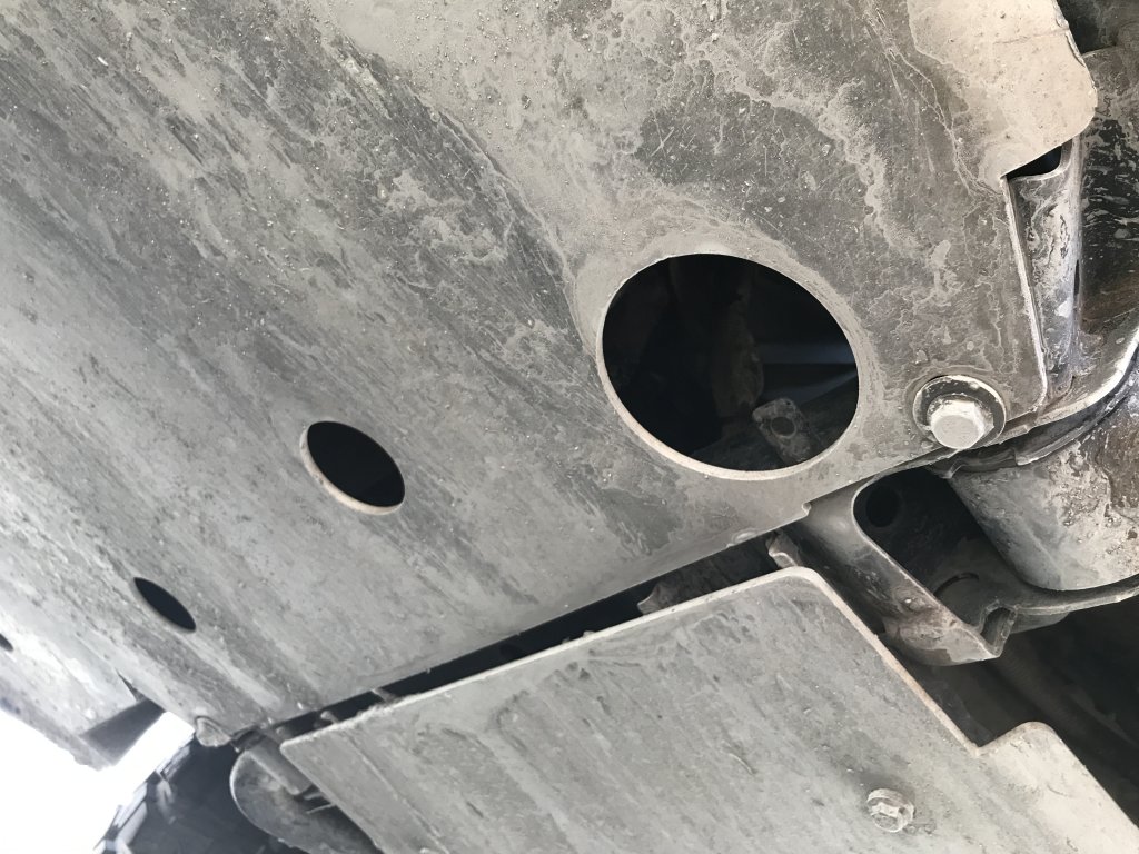

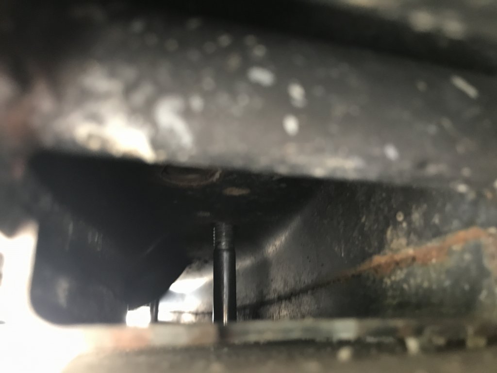

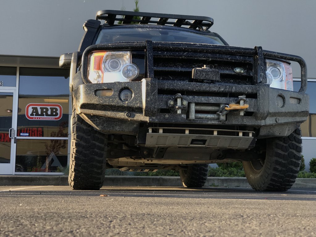

Here are a couple photos of my Rasta transmission plate in the middle, and engine plate front. Not sure if it helps at all but you can see the bolt points at least. I bent upward some of the trans plate where it's close to the slider but otherwise all the Rasta stuff was an easy direct fit.
The two larger hex heads here in the middle are M14 that I sourced to refurbish the M12 that stripped out of the welded nut/plate you can't see above this cross member. I tapped out the plate to 16 and it's good so far. In hindsight should've used fine pitch but it's done now.
Trans plate uses 4 of the 6 potential holes but engine plate uses all 6. Front transition lip uses 6 also but was customized to interface with the ARB bumper . It's designed to just mesh with factory bumper cover.
At the North American ARB location today :)
