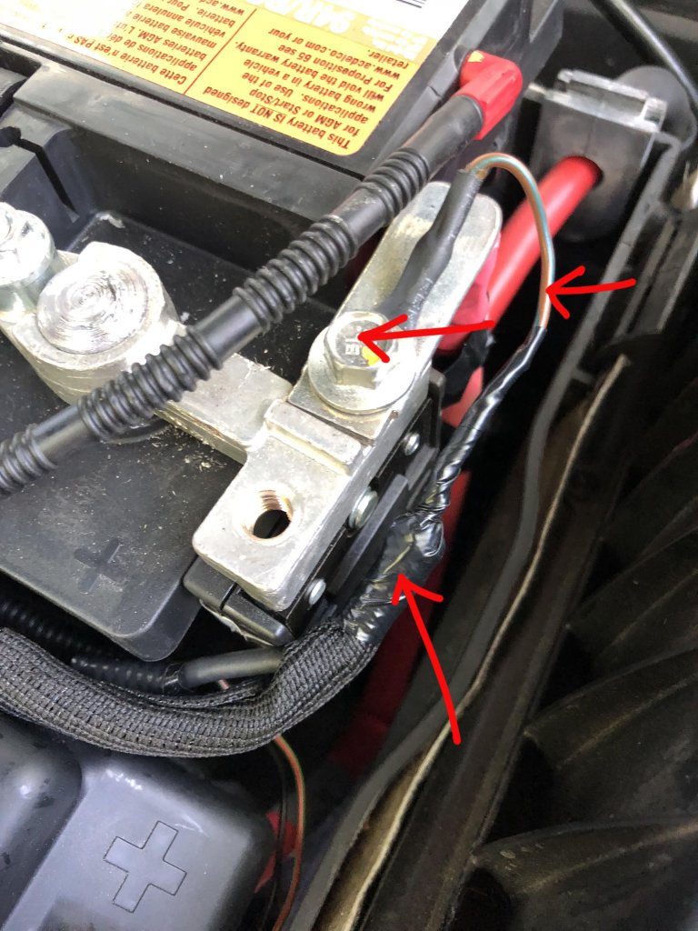

Does anyone know what this wire is?
Mice chewed threw it and until I reconnected it, had charging system fault warning with the red triangle and battery icons lit up.
Wire needs replacement. Any ideas on where to get one?

It is the power feed for the battery monitoring system (the little box on the negitave cable) should be available from Land Rover as a harness overlay.
