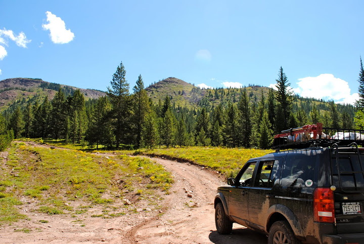

I'm also in this camp. I used a marine NGP (non ground plane) antenna, and mounted to an existing spot behind the driver's tail light. If you pull the light off, you will see a 10mm bolt that fastens a tab from the bumper cover to the body of the vehicle. I fabbed up a small 90 degree bracket that is also held by this bolt, and then also put 2 self tapping screws through it and into the LR3 (they are hidden by the tail light anyway) for stability. Here's a pic that shows where the antenna is mounted...look for the tennis ball and follow it downward:
You can't really see how its mounted, but its fairly obvious what you need to do if you just yank the tail light out. I can prob snap some better pics if they would be helpful.
