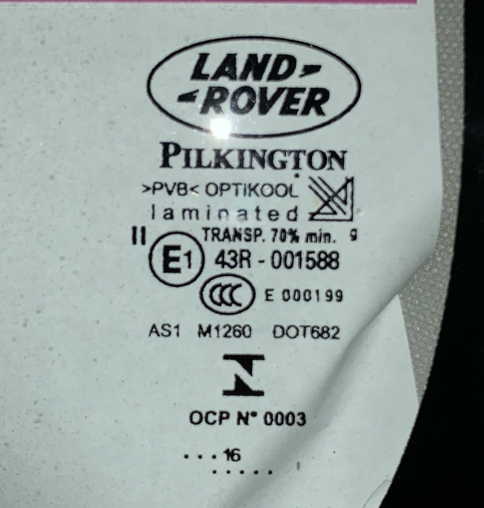

FYI - I had the Fuyao as a replacement and the rain sensing headlights were erratic. Didn’t work. It’s a known issue.
CarMax had put that in so I went back and requested the actual OEM, which is the Pilkington and everything works fine again. It’s something about the tint of the glass, I think, which is just slightly different and mucks up the sensor. Or maybe it’s the sensor if it comes with the windshield. I forget. Anyway, I attached a picture of my heated replacement as an FYI -
1,412
Interesting. My Fuyao has been working fine with the sensor. Maybe they learned, who knows. Glass only last 2-3 years here anyhow so I don't get fussy about it.
