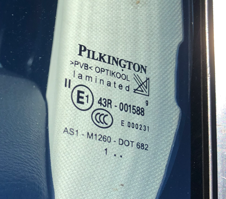

Pilkington is the OE supplier. I have had both Pilkington LR branded, and the non LR branded and the only difference is the Land Rover logo. Just make sure your glass shop buys new OEM A pillar clips. You absolutely cannot reuse the old ones.
The glass is also set with a pretty thick bead of the urethane adhesive, so it is putting a slight amount of pressure on the A pillar trim. If it doesn't, then you will get a lot of wind noise.

Well you need to find out who makes the “aftermarket” glass. There are different companies. If Pilkington makes it you’re good. Make sure it’s the one with the heating element too, unless you don’t want it.

I believe Pilkington is considered a very high quality glass manufacturer so I'd echo the sentiment here.

The local glass shop near me in Montana installed aftermarket Pilkington (heated) LR4 glass in fall 2023.
I was disappointed that the new windshield started to look 'sandblasted' in less than a year, but I doubt OE/Genuine JLR glass would have been any better, and there is not one single JLR dealership in MT.

Safelite replaced our LR4 heeated windscreen last year. the screen is Pilkington branded.
