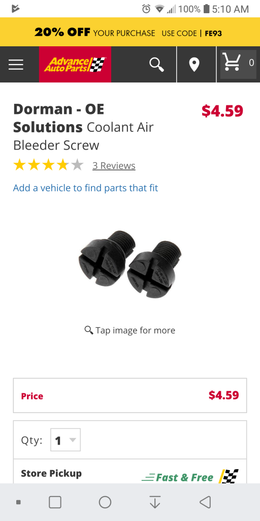

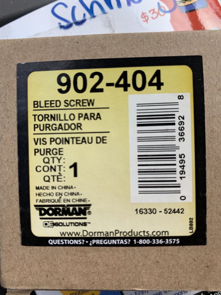

Mine didn't break but was weeping from the center of the X.
Just went down to Advance Auto Parts and grabbed one of these.
Slightly longer (maybe 1mm) than OE but works fine. Not sure what the original application is for.
I want to eventually replace with a brass valve that I can attach a hose to divert the run off. I hate dumping coolant on top of the engine.

Advance auto parts to the rescue! $4.92 after tax! You all just saved me $120! Thank you for the help!
As soon as I find the metal replacement, I’ll post up here as well.
