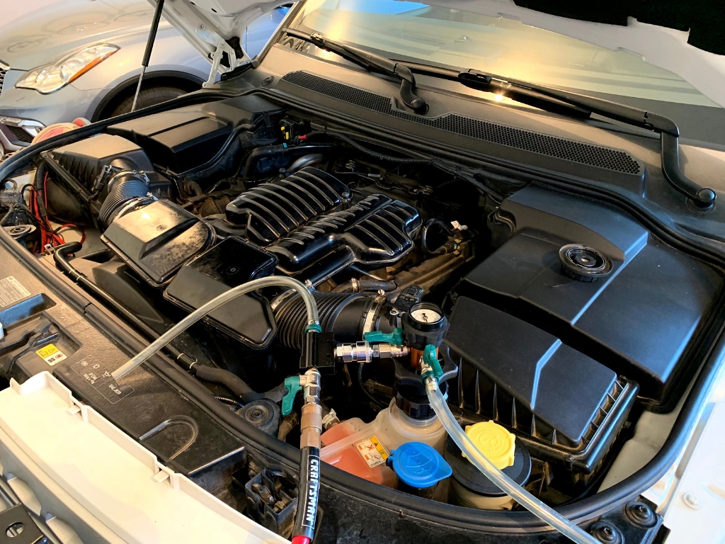

I've been using this for all my cars and it's pretty awesome. https://www.ecstuning.com/b-schwaben-parts/coolant-refill-air-purge-tool/003466sch01/
Basically, you bleed the system and it'll hold a negative pressure. Then using that negative pressure to remove all the air and fill it up with the proper coolant. Genius design.
Here's the manual for it, Coolant Refill / Air Purge tool.
Has anyone used this when the coolant system is already full to make sure it is fully bled, or is it required that you start with a drained coolant system?
Yup, there's different valves on this specific unit where it will vacuums out all the coolant. This same unit will also input the exact amount back in.

My unconventional way of using it, yes. I use it to vacuum it out through the purge tube, because we don't have butterfly drain valves like normal vehicles.
Once the coolant is out, this is how you're suppose to use it.

Just take the lower radiator hose off and let it drain for awhile, then put the hose back on and use the vacuum refill tool to fill the system. It doesn't fully drain the system but it does fill it and keeps air out.
I've drained my coolant and had it filled back up in like 10 minutes not counting the drain time. I can't believe anyone would try to manually bleed these things.
$80 and be done with it. (oh and you need a decent air source, shop air.)
