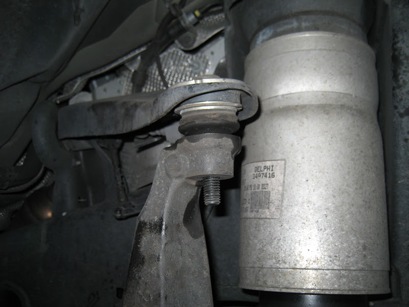

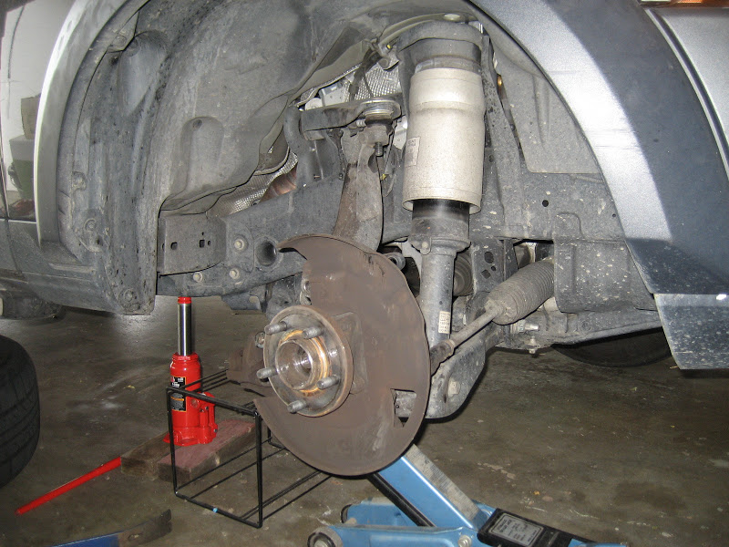

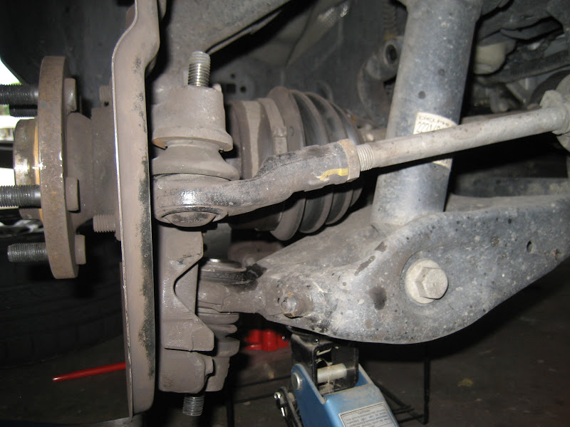

Reviving an old thread. I tried removing the control arms to replace the bushings about a month ago. I got stuck on step 8 of the directions which says to free the ball joint from the control arm. I am assuming this step is referring to the lower control arm and ball joint. Does that mean free the ball joint AND control arm from the hub assembly, or does it mean to actually separate the ball joint from the control arm? In the picture on page 4 of the instructions, the ball joint is still attached to the control arm. Don't I also have to detach the upper ball joint and tie rod ball joint from the whole hub assembly?
Here are some pics of what little progress I did make.

hell pie.
You do have to separate the ball joint from the control arm. The whole control arm has to be removed in order to remove and install bushings on your work bench/ work space.
You do not have to detach the upper ball joint and tie rod ball joint from the whole hub assembly. It will just hang.....and you can swing it out of your way when needed.
I hope this helps.
