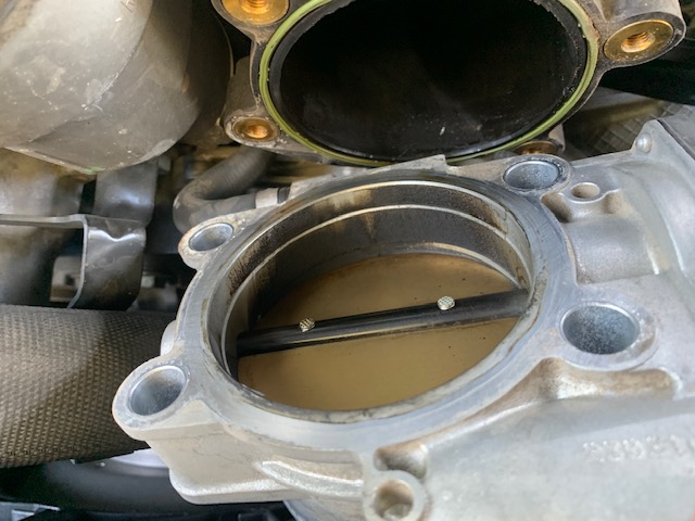

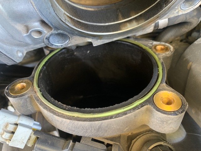

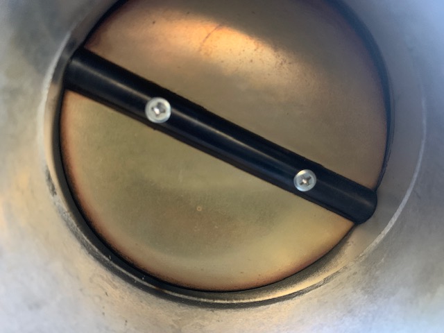

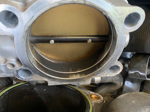

No map sensor necessary. Clean the tb and that should clear your issue. If you YouTube lr4 throttle body clean, you can see it. There’s not much to it.
You just need to get the tb off the intake and clean it really well, especially around the pivots on the flap. Then use your gap tool to recalibrate

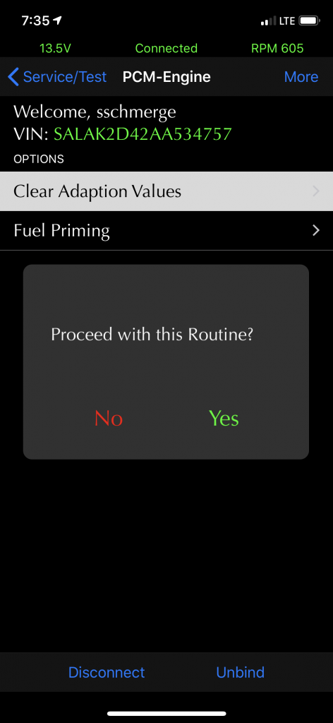

You can clean away! Moving the throttle body “flap” is necessary to get it really clean. Once you’ve done that though, you’ll likely need to recalibrate. I’ll look at my gap tool in a couple hours. If I recall correctly it’s under the PCM function
Edit:
So you need to clear adaptation values.

Went to the LR dealer and bought the sensor since i figured i do both jobs at the same time just incase. fairly straight forward. i didnt disconnect the 2 hoses going to the throttle body as i was able to clean everything needed. Suffice to say, it was black as nite in there :) Followed your steps with the GAP tool and started the engine up. MUCH better!!!
