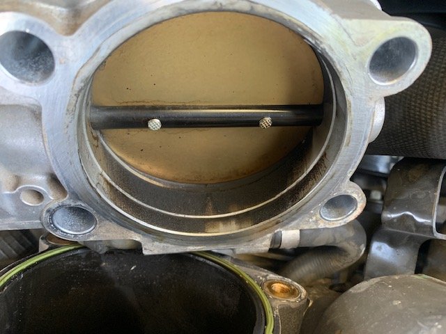

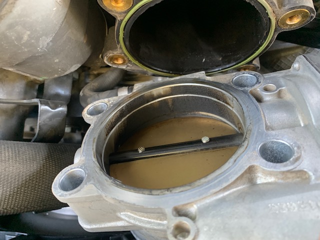

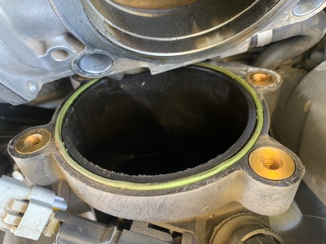

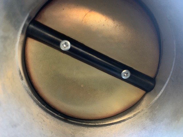

Went to the LR dealer and bought the sensor since i figured i do both jobs at the same time just incase. fairly straight forward. i didnt disconnect the 2 hoses going to the throttle body as i was able to clean everything needed. Suffice to say, it was black as nite in there :) Followed your steps with the GAP tool and started the engine up. MUCH better!!!

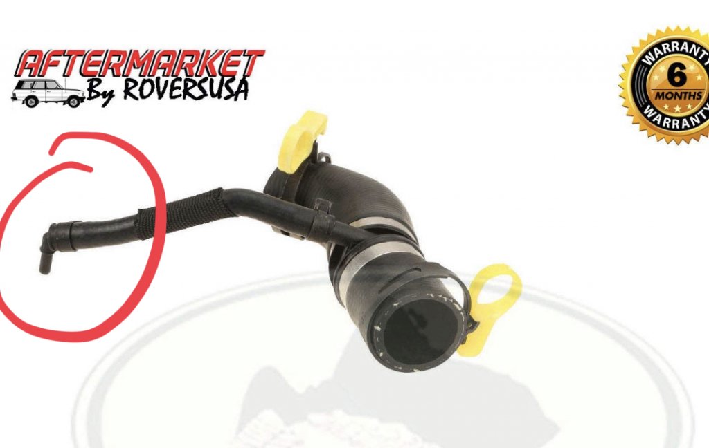

This am I saw “low coolant” warning. Got her home and she was definitely leaking somewhere. Replaced cross over pipe and sure enough it had a crack. Put everything back together after checking my work.

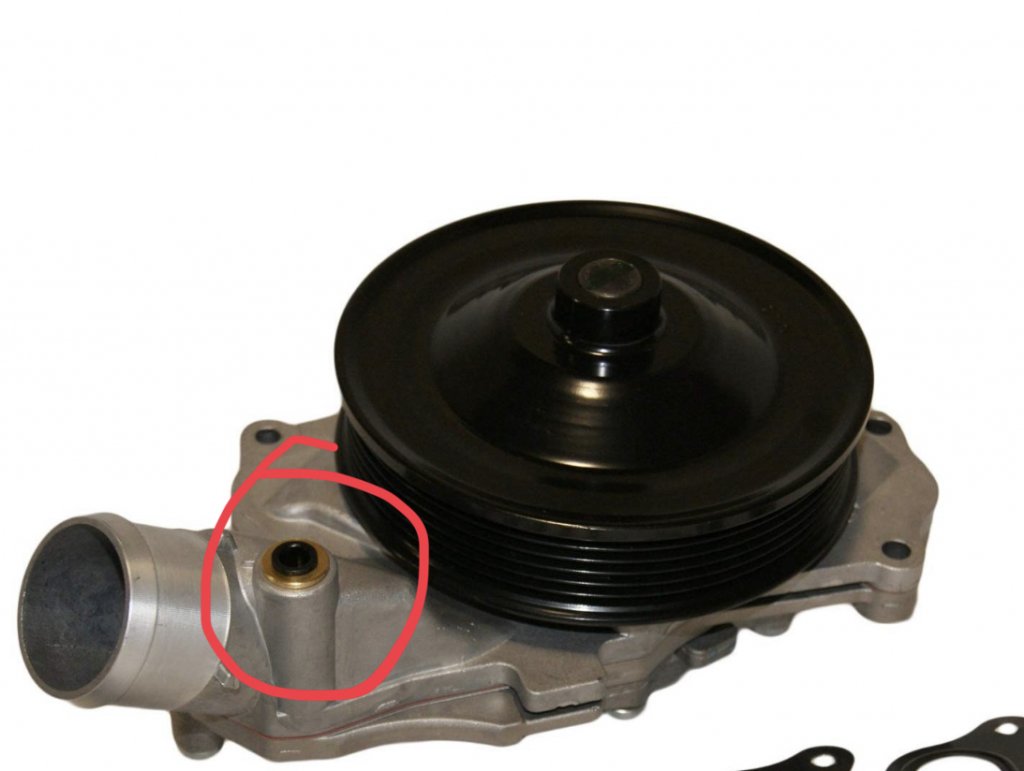

Wife turned her on and I could see it spewing coolant from where in the vicinity of the water pump. Suffice to say, I’m stopping here and having her towed to dealership. Did some digging in past invoices and saw that less than 2 yrs ago they replaced water pump and all associated tubing and seals. Hopefully it’s all under warranty!

So, there’s a small hole on the water pump that is a return. The hose design has been updated and pressure fits into the water pump. I snapped mine when I did my water pump (very brittle). Id start there if it was leaking. easy fix.
