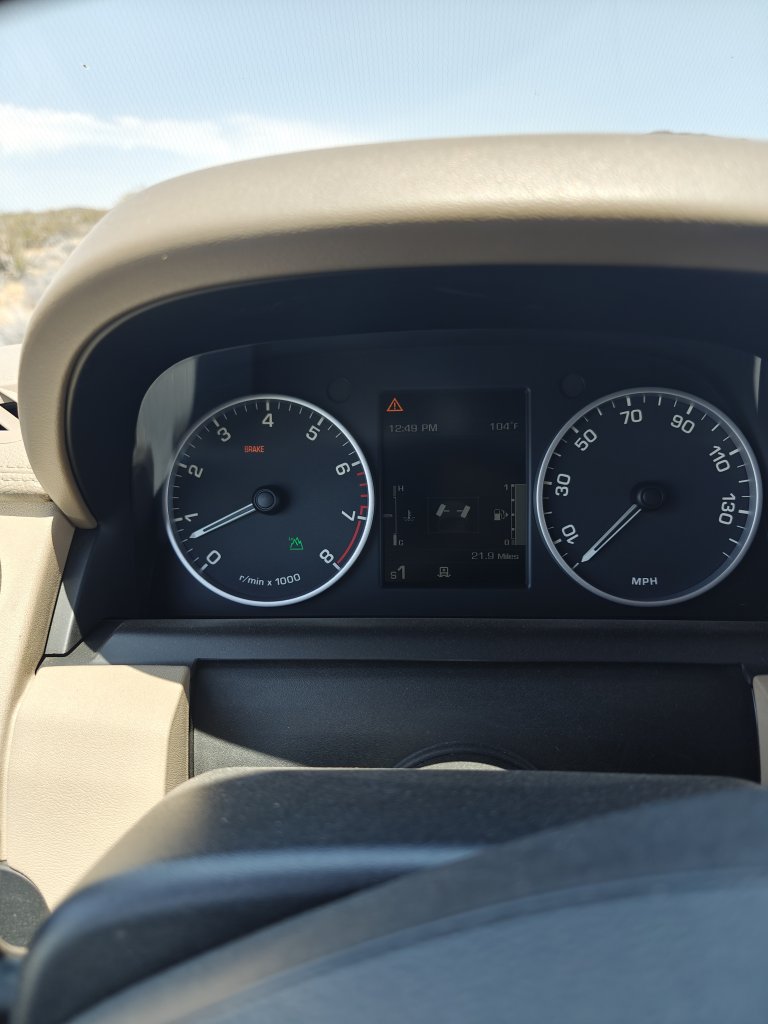

I tried out the professional way of switching the transfer case and its a better experience to make the switch while moving. The LR4 doesn't stop impressing and its AWD traction capabilities are amazing.
powershift
Jul 20, 2023
763
232
Nevada
I'm super curious about the diagram of the front wheels in the DIC. When I turn the wheels in 4L the diagram appears and when I travel straight it disappears. I can see that I'm turning since the wheel is right in front of me and I already know that I'm turning. I'd have to be pretty lit to be using the DIC to determine if I gave steering input. I'm wondering what the use case is for it, any ideas?
