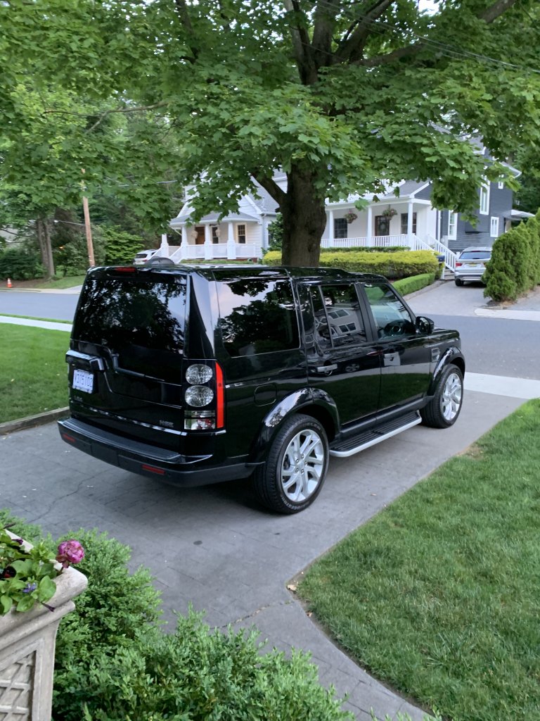

Newbie over here! My 2016 LR4 HSE Silver Edition was serviced in November for an oil change. I purchased it in of June 2020 from a Land Rover dealership. The coolant level alert is telling me it’s low, but how can that be? One doesn’t go through coolant that quickly right? Based on experience, do you think it could be a leak or a sensor issue?
Thanks so much in advance. Attached a picture of her for fun.
