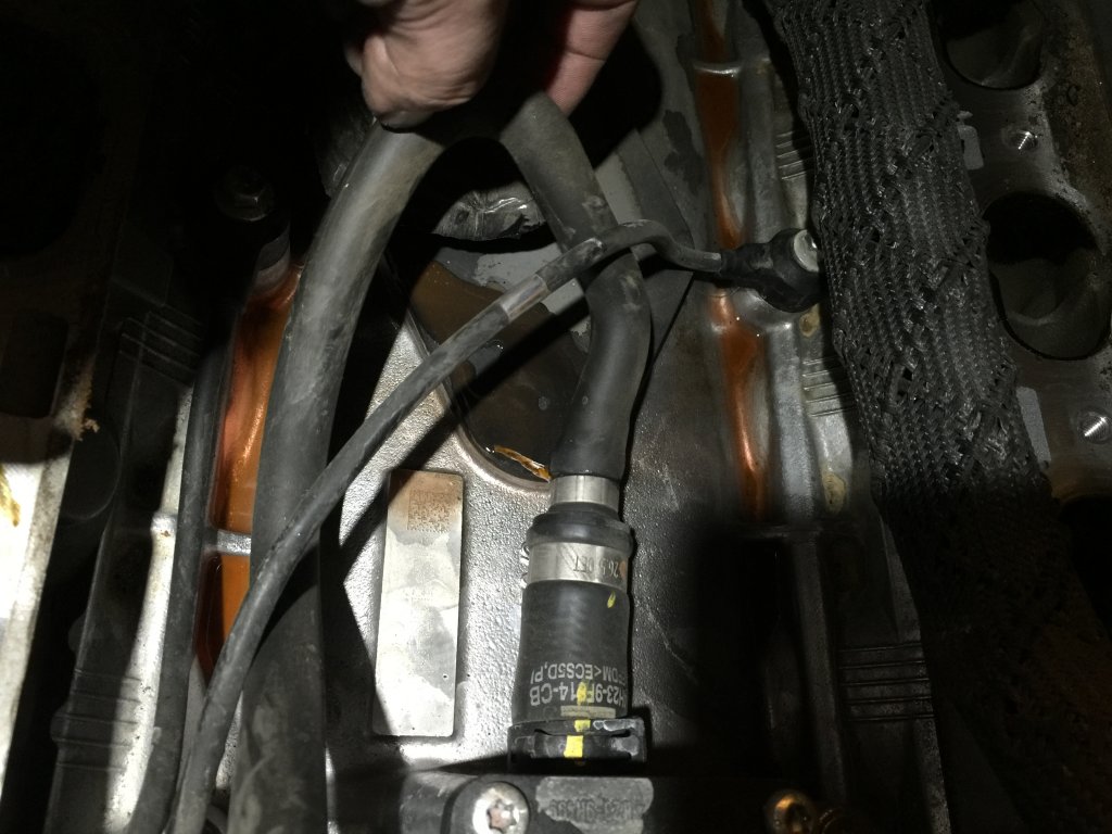

There’s a coolant hose under the inlet manifold that can leak coolant and it can pool on the top of the block. It can also get into the oil and I had elevated levels of silicates when I had an oil analysis done at the time.

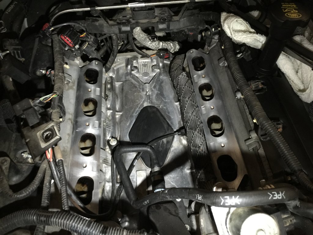

Anglotron, I have actually just replaced all the hoses, including that one (actually posted a guide on how I did it without removing the intake manifold in the other forum), and I check the area just above that hose from each and every time I drive now, seems bone dry. Nevertheless, it is a brand new hose, and I verified it was full seated before reinstalling the throttle body, etc. Thanks so much for the tip, though!
