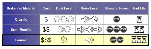

Power Stop is good. They produce all types of pad materials so have no bias in selling one over the other. Their little chart sums up my experiences. Ceramics are cleaner but ultimately don't have the feel or power of original. They can feel "wooden"
Just me but I'd go for the stopping power..............

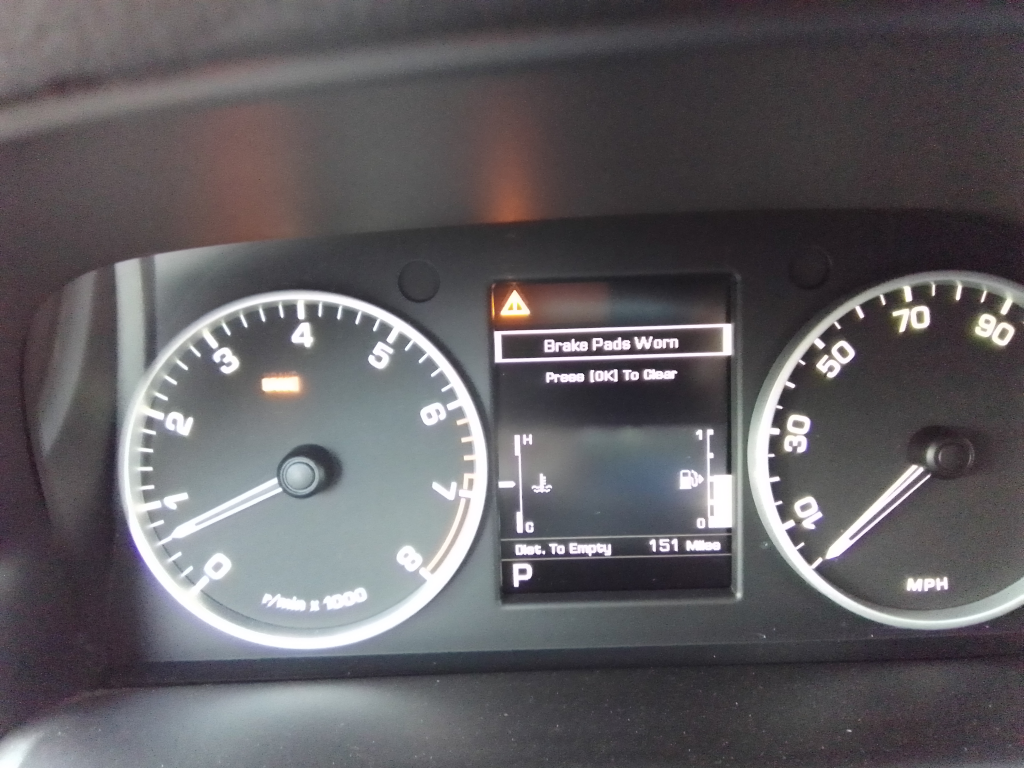

"Doc, how long do I have?"
1,874
Not long. Realistically, the pads are worn too far by the time you get to the sensor.
I had that warning pop up once, but it was my rear brake pad sensor that went bad. Pads were still good.
1,415
I just did a simple flush with no problems, no electronic wizardry. Brakes are always fun on these things. Usually rotors every second pad change. Lately rotors have been Zimmermann or Brembo. Pads have been Brembos.
