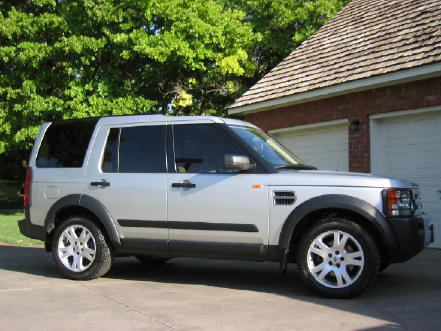

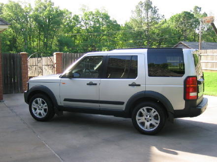

Here's a few pics of my LR3 with the 19in RRS wheels and GY HP 255/55/19 tires. I have a pic somewhere of a black LR3 with the 20in RRS wheels that I saw parked in Dallas, but I can't seem to find it. If I come across it, I'll post it.

Looks great man, thanks for the pictures, They make the Rims Pop since they are not so simple like the factory 19's...
please try to find that pic if you can because right now that is what i am looking to do is put these sweet looking RRS 20's but would love to see them on the car first...
