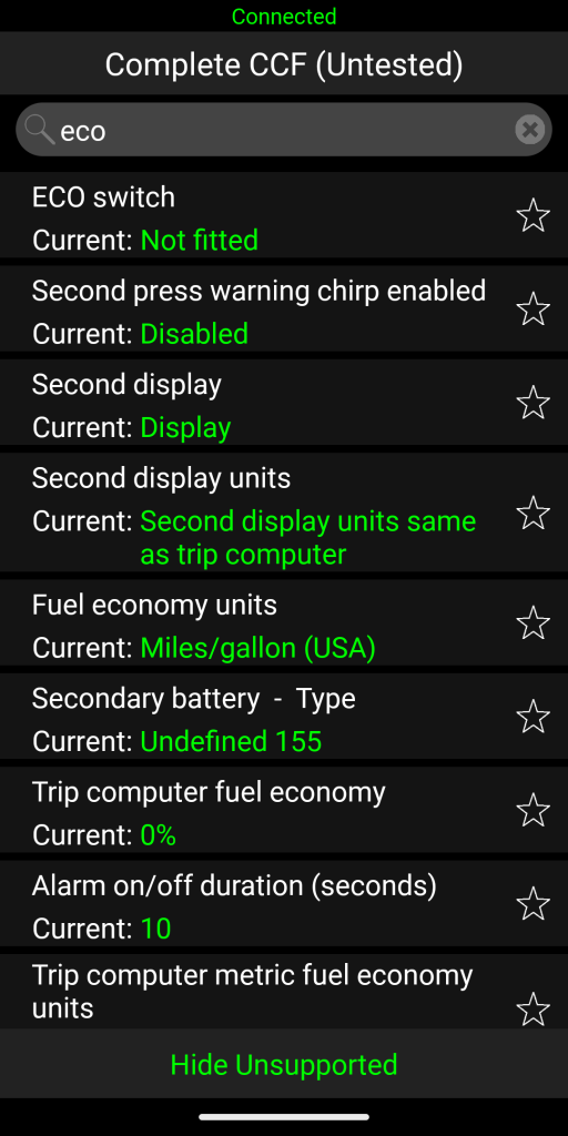

scapistron
Aug 30, 2023
247
149
Massachusetts
While setting up adaptive speed control I saw a CCF in the GAP tool for "ECO switch". I set mine to "not fitted" and have not had the start stop system activate over the last 30ish miles. Keep in mind there's a lot of factors that go into whether the system activates, but so far it has not.
Mess around with the car config at your own risk. With great power comes great responsibility.
