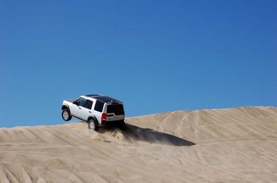

Bummer, I had a lot of info posted on this before the server hiccup'd.
The LR3 does good in sand, appropriately tired. Even with the stock tires, it's not bad. The locker is more valuable in sand than traction control.

That's a nice pic!
