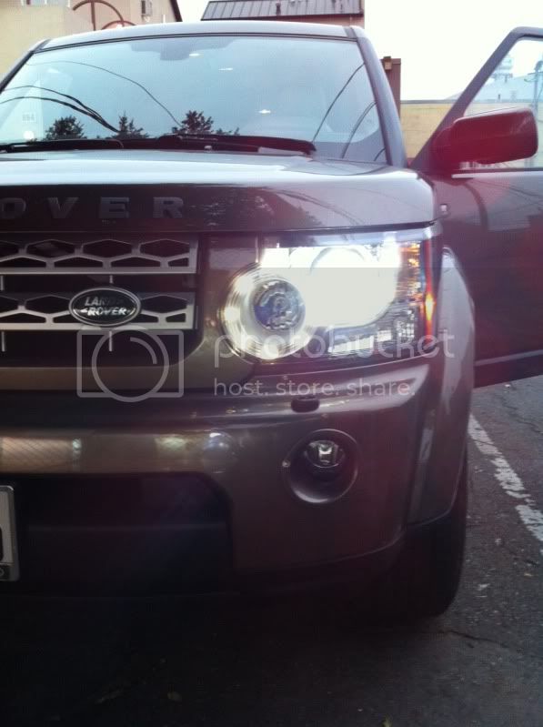

I used Circuit-on-board (COB) led rings. They are cheap and very bright. Order and extra set as spare. I had one die in the 1st week, but been solid since. 100mm in the headlights, 80mm in the fogs:
100% brightness (get a DRL controller to dim 50% when headlights are on)
~35,000 Lumens

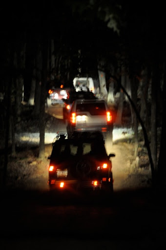

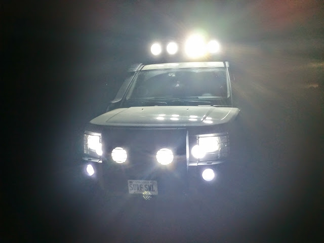

YES - This Friday is the land rover Uwarrie Safari in NC. There is always an organized night ride. Wheeling at night is a very different experience. Its tough to shoot pics or video at night, so never seem to have may good shots:

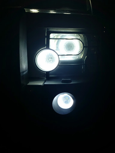

If I were to do the LED rings again, I would only do the headlights OR the fog lights.
IMHO - My headlights look much better than the 2010-14 LR4 DRLs. Criminal how much LR charged people to turn those on.
The fog lights are 100x easier to do than the headlights - no baking required to open them. I still might have to move the fog light rings to the offroad lights circuit to pass state inspection.
