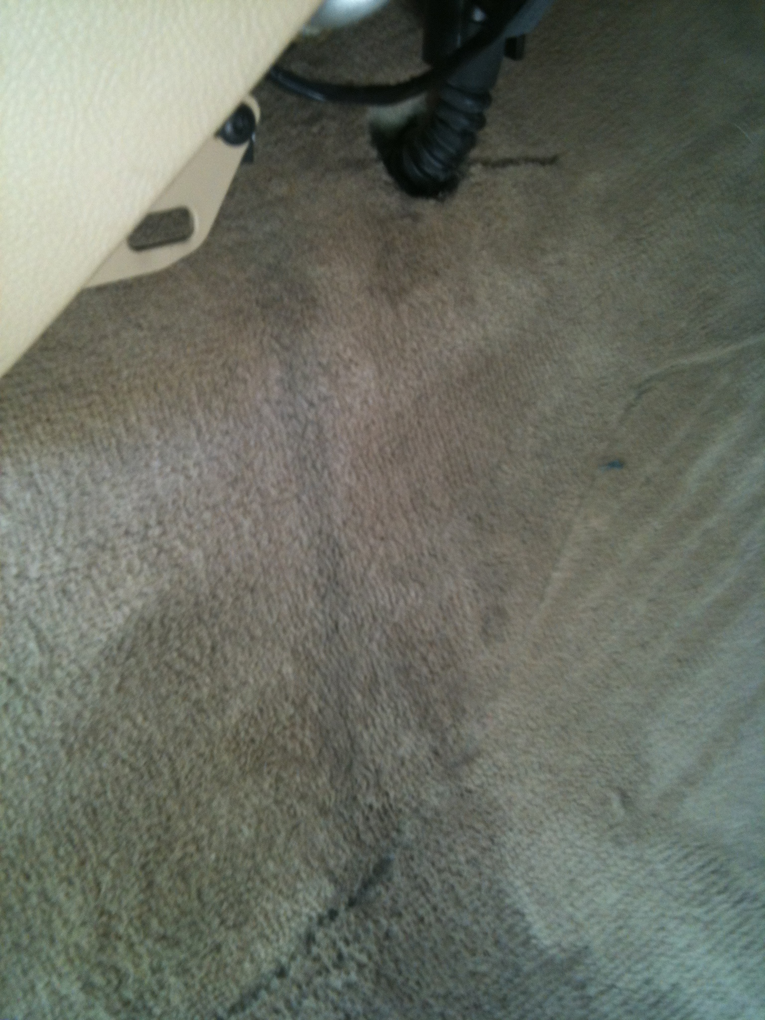

Both sides of the front floor mats were wet, the passenger much much more than the driver. I dried it out, left the rubber mats out. Next day I'm driving and I notice water coming from the center console under the dash, but I'm not exactly sure from where. See Pic. The carpet around the black rubber hose was wet, but none of the components above the carpet was wet/moist. If I pull gently on the black hose, water will start coming out at the connection. What is this hose for? Is the hose unrelated to my problem? It is July in So. Cal., i.e. no rain, but I did take it to a car wash about 3 weeks ago.

Just dealt with the exact same issue. It's the air conditioner condenser drain hose. It's clogged. Pull it loose from above, and use and air compressor to clear out the drain. While ruling the a/c on a hot day, water should drip pretty steadily from around the front of the transmission if it's draining properly.

Thanks for the help. My problem was the AC drain, but the dealer service fixed it for me. They cautioned me on doing it myself. See post (date 7/10/13) under thread "floorboards soaked, and I mean SOAKED"
