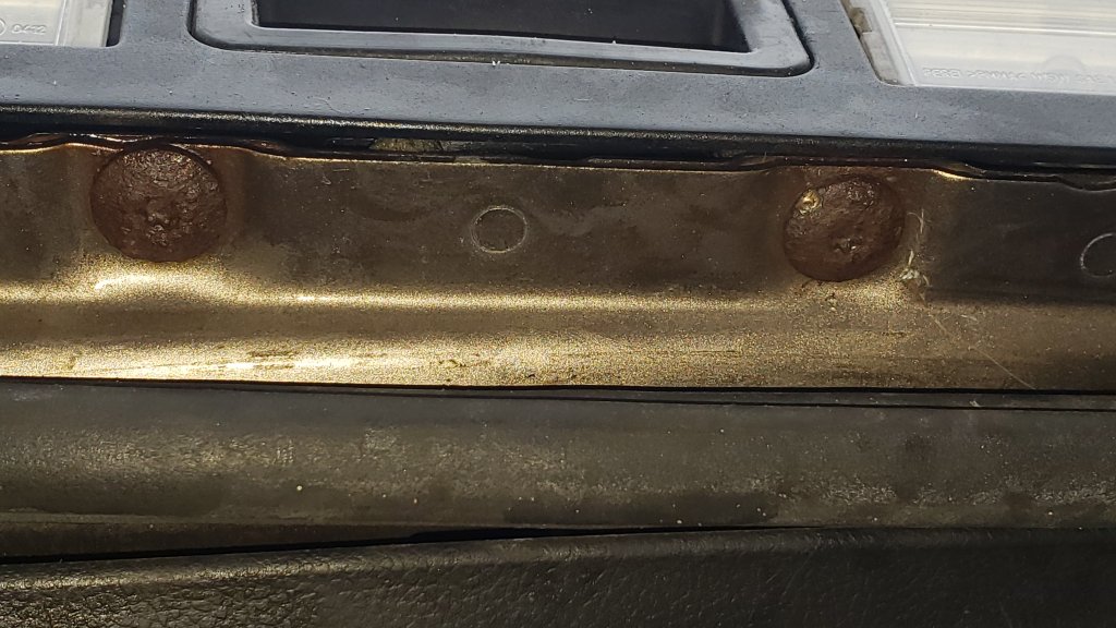

Next I looked at removing the whole switch assembly unit as you did to see if any switch wiring loom wires broken. Its only held in place by three large head torx 27 bolts right? Obvs mine are quite corroded and will not undo. LARGE DIA BOLT HEAD AND TORX IS GUARENTEED PROBLEM IF RUSTED!!!!! Just like brake rotor retaining screws :( dosed liberally with WD40, gave them a sharp tap with a hammer. Will leave overnight and try again later.
Probably have to use an impact wrench, but problematic as liftgate raised and will flex when I whack the wrench...... and working above head height. Wont be accessible from inside when liftgate closed. Can't use heat as will melt the switch holder assembly. Could grind them off but they are an odd bolt to replace. May have to resort to bolt extractor. 2 deg C and snowing here. Enthusiasm waning (vehicle outside)...............

I figure I have a broken wire in the loom which powers the liftgate switch as per Ryanjl, so need to remove tailgate handle to investigate. Both rear license plate bulbs blown which supports a wiring issue diagnosis. Obvs never that simple!
4 torx bolts that hold the liftgate handle on are rusted solid, so have to drill and remove heads, drill out and re-tap.

Turns out it wasn't the wiring per se. I checked the voltage going to the liftgate switch located in the handle. 12V. Big relief! I then connected a jumper lead to bridge the switch and the actuator whirred. The switch was therfore the issue. Ordered a $25 non-OEM switch which should arrive today. Three snapped bolts drilled out and re-tapped (pain to clamp the handle unit when drilling). I even went as far as touching up the paint on the handle as there were a few chips. Hoping to have it back on this weekend so the dogs can finally go to the beach again!
