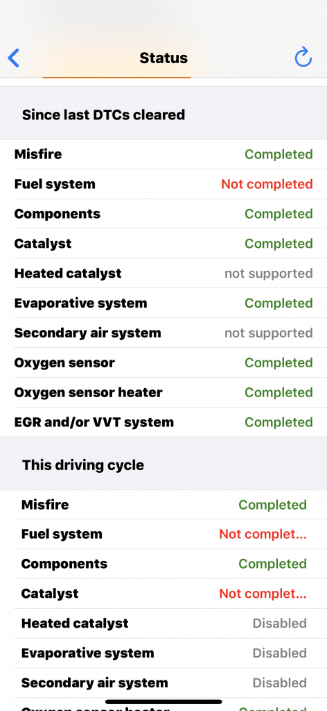

Hi,
I am trying to get the smog done on my LR4. The battery died from just sitting there and the DTC systems got reset. I drove the car for over 100 miles and followed some drive cycles recommended and all the cycles completed except the fuel system cycle.
I don't find much information on the web on how to get this cycle ready. I currently don't have any codes or faults. I took it to a shop to have a look at it and they just recommended to just drive it. I have done that but not seem to complete
Wondering if someone else have had this issue in the past and what was done to get the fuel system cycle ready.
Any suggestions or help is appreciated.
Thank you
Thank you
