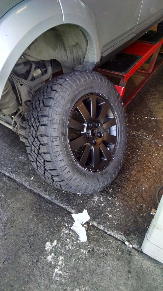

They rub and knock off the balancing tabs so I need to get them balance with the bags

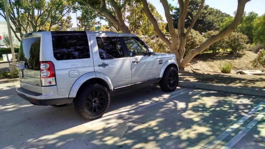

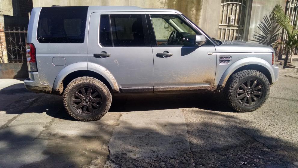

Duratracks 265/65r18 tested them a bit on mud and sand they did great had to air down on sand but they got me to were I wanted to be. I run them on 40 psi anything less and it feels like a water bed very mushy. Love the tire.

Those of you with the 265/65r18 Duratracs: how have they held up, considering the "lower" load rating being used with the heavy LR3/4?
They actually have a higher load rating than the OEM size at 114. They do great.
They have a lower speed rating (S).
You'll have to run them at 40psi or more on road (I do 44). I haven't had to air down on sand (even deep and soft) but I have aired down for better comfort in rocks.

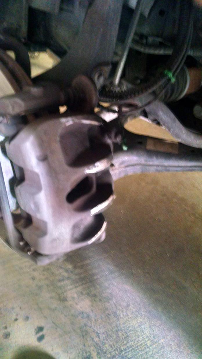

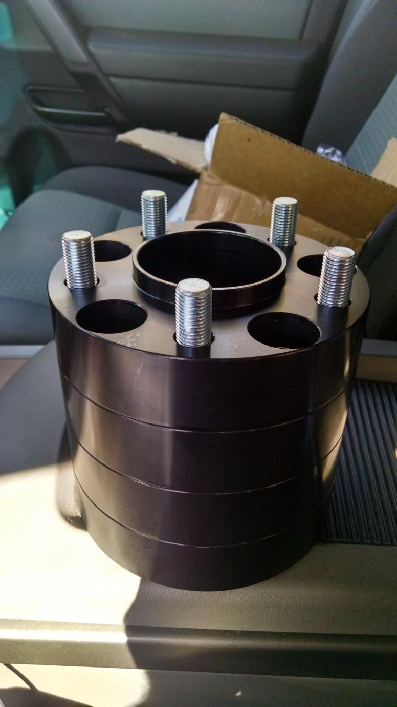

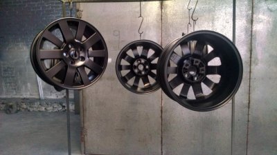

Had the rims powder coated, used 1.35 spacer hub centric, had to grind the calipers. Runs great but the tires rub on the frame.
