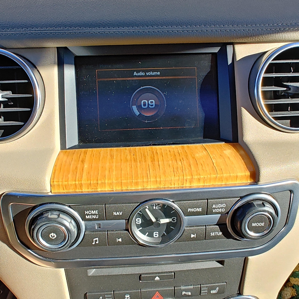

There is a setting in the infotainment to show the volume numerical value. It's either under system or audio. Let me know if you can't find it and I'll find it on my car and let you know.
Thanks, I'll see if I can find it. I need to pull the codes today for the check engine light too.
I didn't find the setting to show the volume level. There was a page that had volume level presets for things like nav, voice, phone, etc.

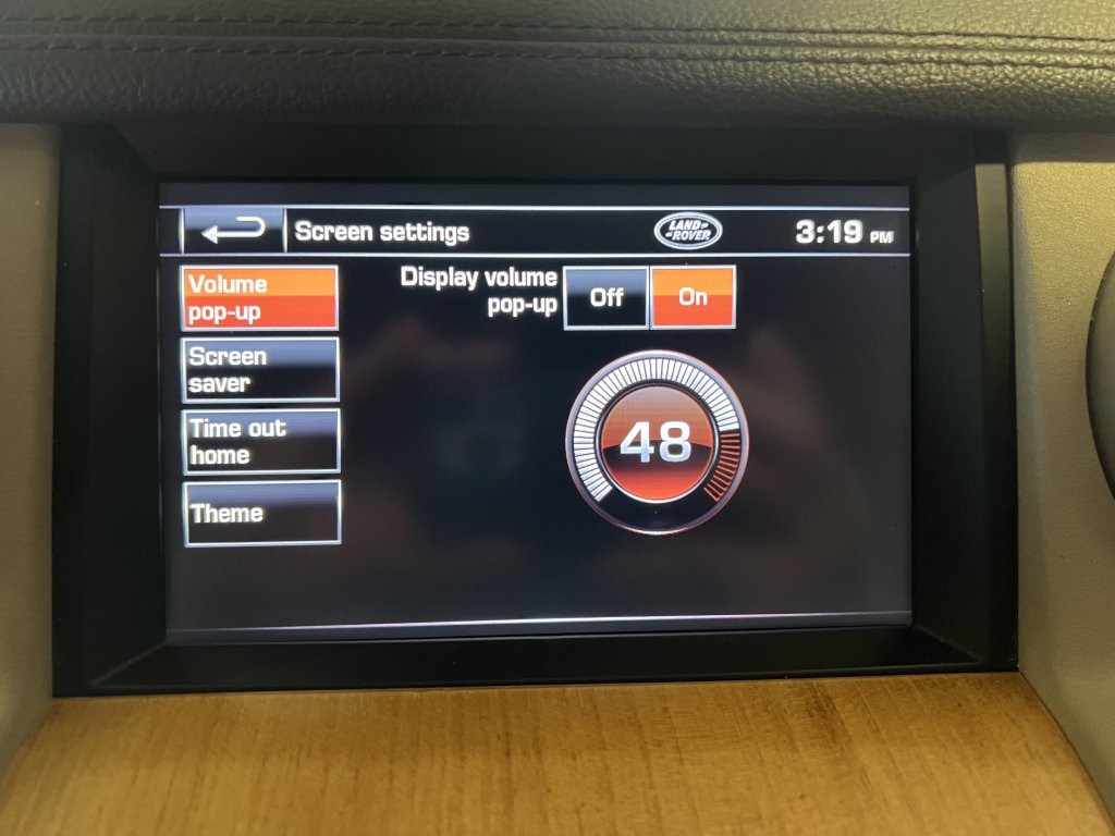

Sometimes my BT connection acts up and I'll turn up the volume but don't hear ****. Then if I get it working I have that **** blasting ear piercingly loud. I've learned when I don't hear audio, don't keep turning it up lol. If there was a number that I could use for a volume level that would be helpful.
Setup Button, then Screen Settings.
