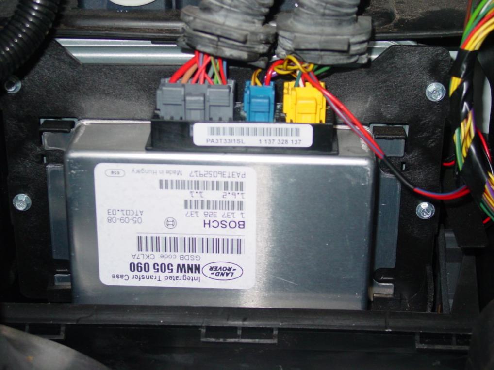

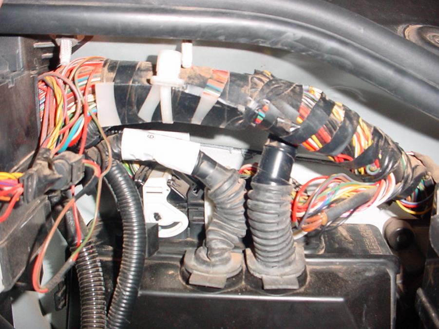

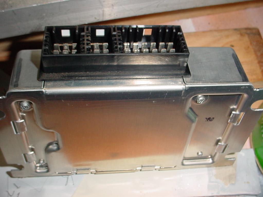

3 M black electrical tape
Now that you know where the not waterproof electronics are located, you may have noticed that those two rubber boots where the wires go thru are actually water channels into the electronics rather than what they appear to be.
As such, I wrapped some black electrical tape around the top of mine where the wires and rubber meet to try to close off the water channels. This does not make the unit waterproof, but it does inhibit water entry from the top so to speak. Of course the rear remains wide open but we try.
