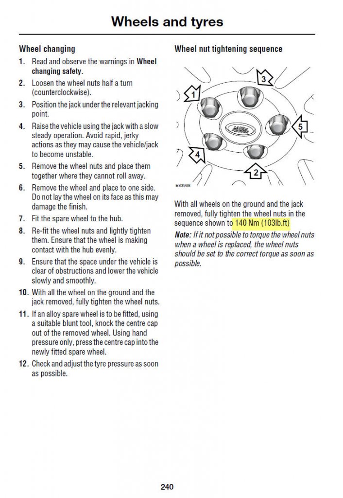

For my MY16, the handbook dictates 98 lb.ft. Experienced local tire shop wants to torque to 105 lb.ft to make up for the extension lever (or whatever its called). The dealership wants to do 110 lb.ft.
Asked the dealership shop foreman as to why 110 lb.ft vs handbook' 98 lb.ft, reply was that 110 lb.ft was to make sure if the vehicle were to go off roading. Asked why this info wasn't mentioned in the handbook, reply was that there were many things not mentioned in the handbook :)
Not sure who to trust given the history and my personal experience with the level of knowledge, and the level of care I might add, at the dealerships in general. He could very well be mentioning the torque value for the D5 without even realizing it as I have found in the past wrong values for different things being cited by the service personnel at various dealerships.
And to add insult, I have found wrong values/diagrams/typos, and some leftovers from the past model years, in my '16 handbook. So who knows if even this official value of 98 lb.ft is totally correct :)

Screen shot attached from the FSM which shows 140Nm / 103 lb-ft... do other manuals show something different? Now I wanna check the owner's manual in my 2010.

You are splitting hairs between 95-105 ft lbs (I do 105 ft lbs). Most tire torque wrenches will be +-5 ft pounds easy. The important thing is to not put them at 50 or have some idiot in a garage hammer them on with an impact to 200 ft lbs.
Exactly...you can't tell the difference between 98 & 110 ft pounds. Anywhere in that range will be fine. It's the 200 ft pound impact air gun that will be a nightmare if you get a flat tire.
And as noted above, I already replaced 3 lug nuts with twisted caps from either too much torque or someone using a close-to 22 mm english socket.
