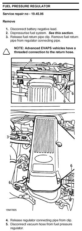

where is the fuel pressure regulator located on a 97 range rover 4.0 engine, a photo would be appreciated, if not explain it to me in relation to something, say.. the throttle or the battery.Thanks!!!!

You have a few post basically concerning the same thing... anyways.. here is the location of the regulator look at number 3 in the pic. But the odds are this is not your issue.
