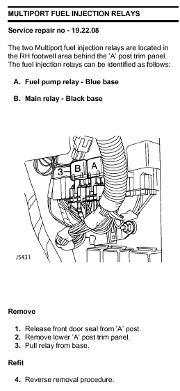

Does any one know where the fuel pump relay is located?
Thanks,
Mark

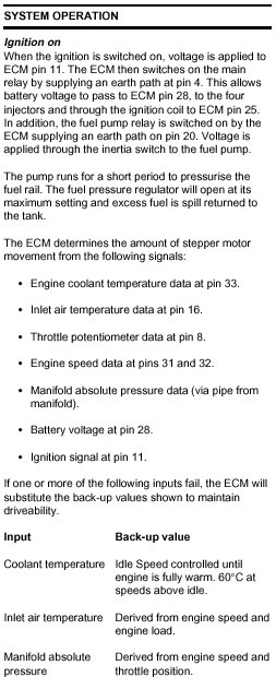

Passenger side foot board area...
