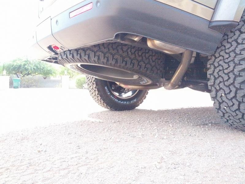

Hi All,
I have a question regarding putting a full size spare tire under the car. I have 18in 265/60 AT BFGs and wanted to put my spare in the compartment under the car but it seems that even fully deflated it does not want to fit there. I read somewhere that in order to fit an AT 18in tire one needs to remove the heat shields (black plastic covers). Has anyone done it? I am afraid removing them and then having the tire melted.
Any guidance will be greatly appreciated!
Best,
Michal
Hi Michal
I have 18 inch compomotive wheels with BFG TA KO 265/65/18.
You should have no problems getting the spare under your truck.
Just remove the heat shield and keep the spare at 8 PSI. ( make sure you have a compressor in your trunk in case you had to use your spare )
When you are placing your spare tire under, make sure that the front end of a tire goes up first and then the back end. You will have to "gently" push or kick it in.
For everyday driving I keep my spare under the car but when off roading I move it into the cargo area ( for easy access) and put my original full size under the truck ( just for extra protection). I already moved my BFG spare in and out several times and it is easy.
I would not worry too much about removing heat shield. There is still some room over there between an exhaust and a tire.
I was positively surprised that my spare BFG 265/65/18 did not stick out lot more that an original full size wheel.
Check the pictures.
