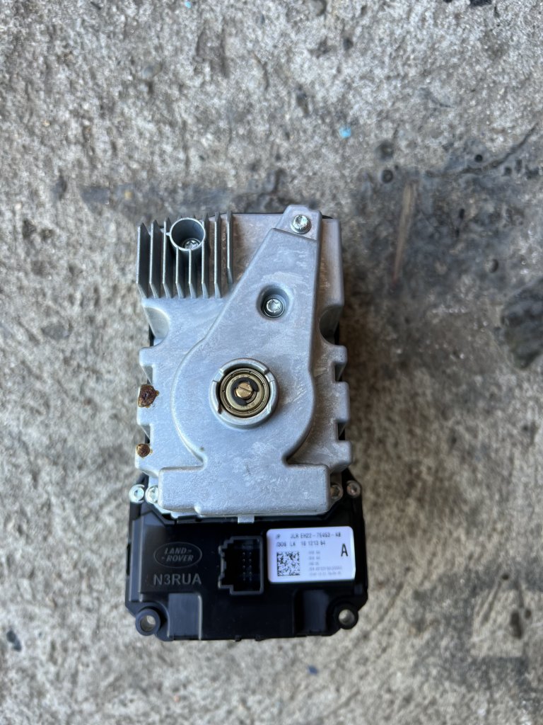

Here’s some pictures for comparison.
And a warning to everyone else. These electronic gear selectors don’t like cola being poured on them.
Also just before it died the illumination ring went out.

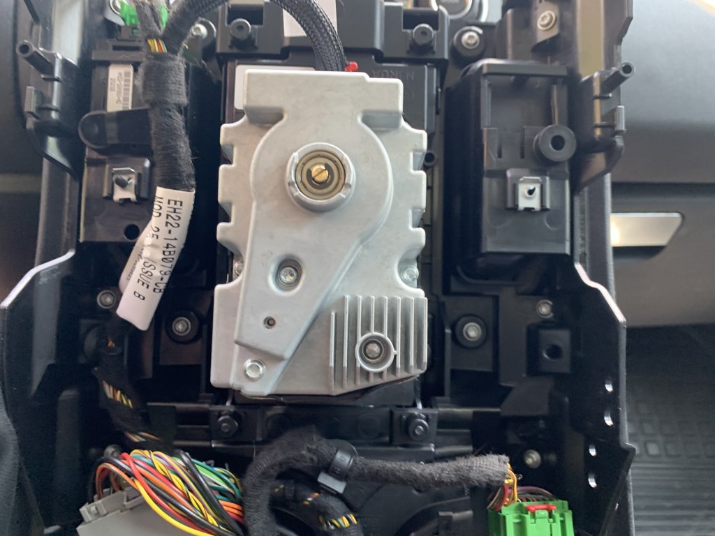

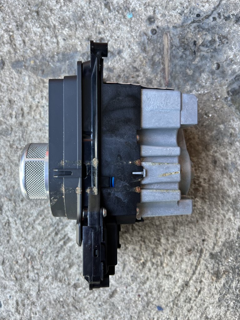

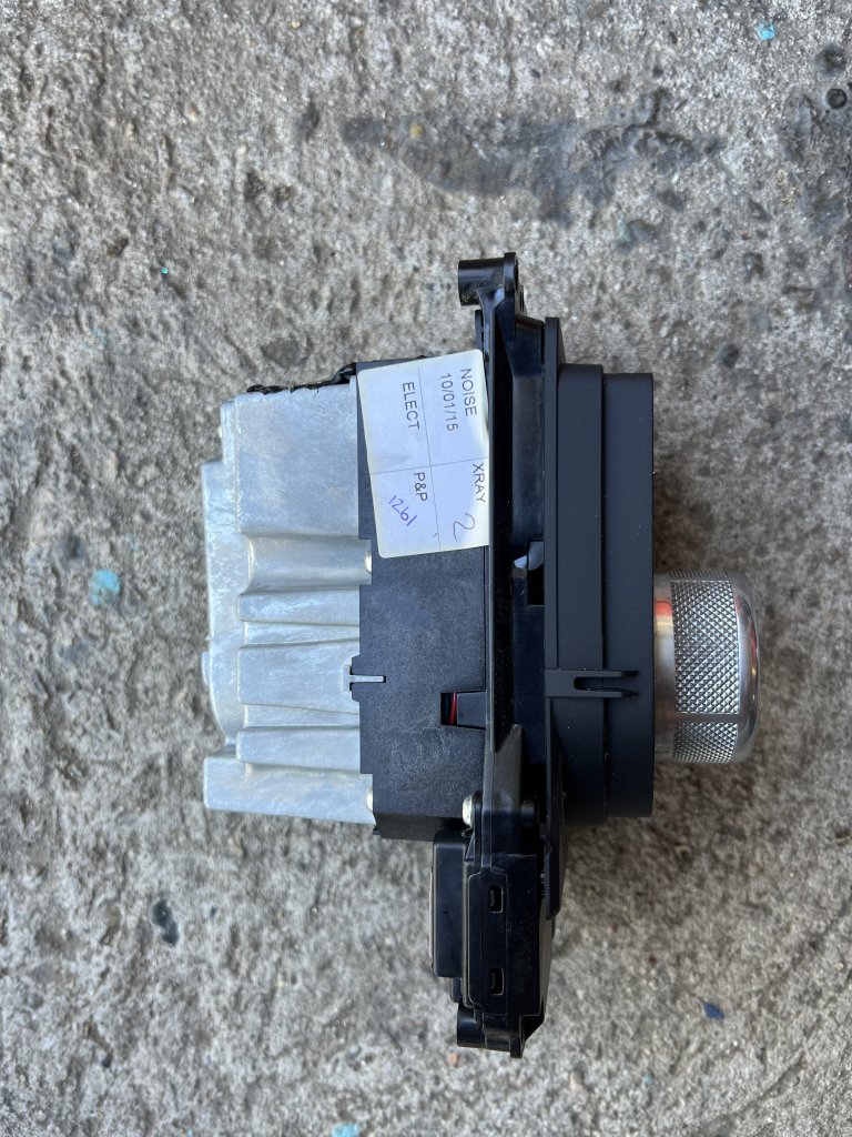

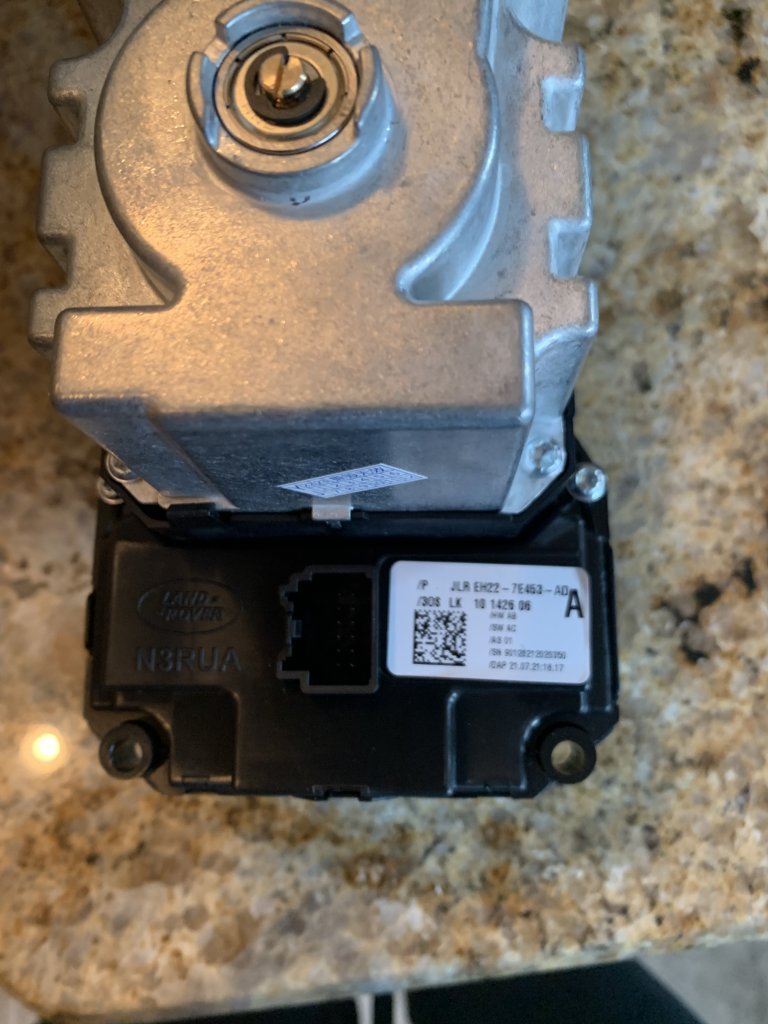

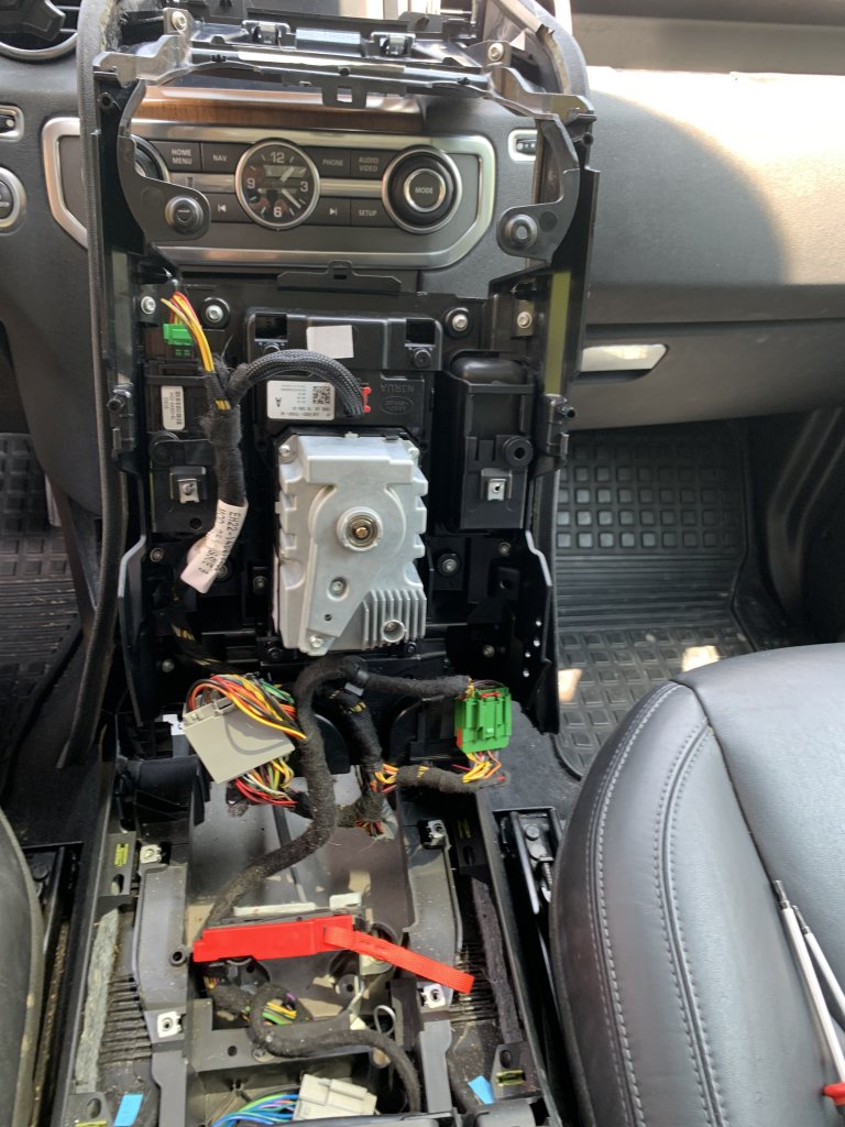

Thanks for the reply, I’ve pulled the faulty module out to confirm part number. Easy piece to replace, simple plug and four screws and it’s out. Just worried the eBay version will be knockoff. Of course, only other option is truck sits for 3 months, so worth the risk. I’ll post the results when replaced.
Pics of the old as I pulled it out.

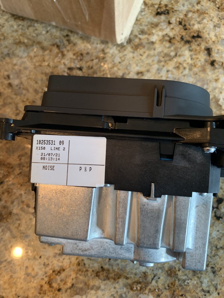

Update: eBay part arrived today, although purchased from seller that claimed to be in US, item shipped from China. Arrived in reasonable time, part appears genuine based on packaging. Installed tonight and truck is now driving like normal. Will have to drive for a bit to see if part fails, but quick spin in town showed no problems. I think I’m better off than the 3 month wait dealer stated, only time will tell.

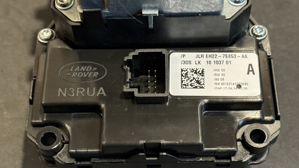

What I took out of my 2014 HSE lux shows
JLR EH22-7E453-AA
(... but LR090489 (per Stuart's post above) doesn't appear anywhere on the part. Some sites say that LR060016 is interchangeable with LR090489.. both are listed as good for a 2014 LR4... they all *look* right with silver dial and black top...)
For parts online listed as LR090489, showing the other number JLR EH22-7E453-, I have found parts with -AB or -AD suffixes.
Found a UK site showing the full range of -AA to -AH...
So, again do the suffixes matter in this part number, or can I ignore?
Thanks.
