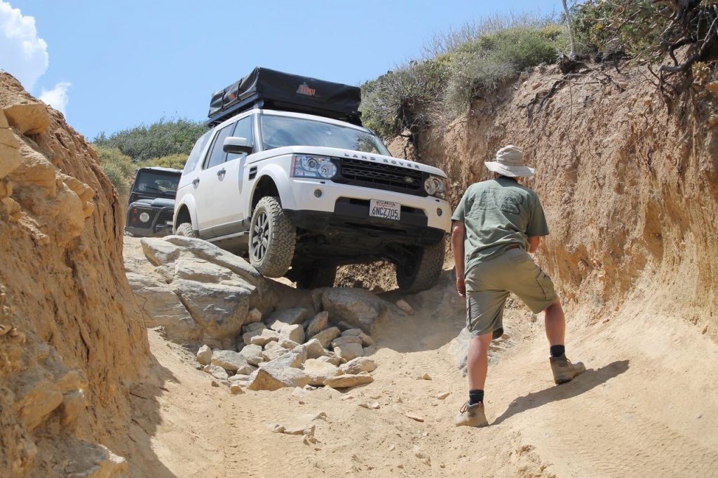

For me, most valuable mods are E-rated tires (265/65), then Sliders (I use Tactical), then gas tank skid. Gas tank is the lowest point and very large..I've heard a few stories of people denting them and reducing their range to 150 miles per tank.
I get over things like this by using the sliders...
