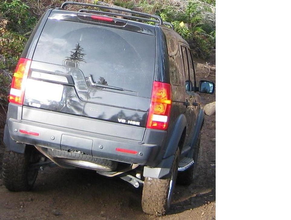

Here's another look at the rig with the mod at-work. Check out the ground clearance!
Duck...this pic (posted on other threads) didn't do it for ya?

Houm, did you want to attach a pic to that last post? I still would like to see a clear
pic of how the MT/R looks on your rig.

Here is the pic I originally tried to post:
