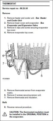

I May be wrong here, but isn't the temp for the fans here:
