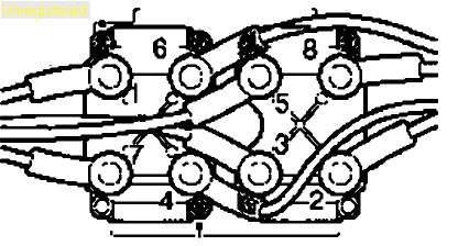

I have a 2000 Disc II we have just changed the spark plug wires and my husband believes one or two is plugged in wrong because it is not running quite right.
Does anyone have a diagram of the spark plug wire set up that you could email us [email protected]
Also, does anyone know how to adjust the timing?

Hope this helps.
