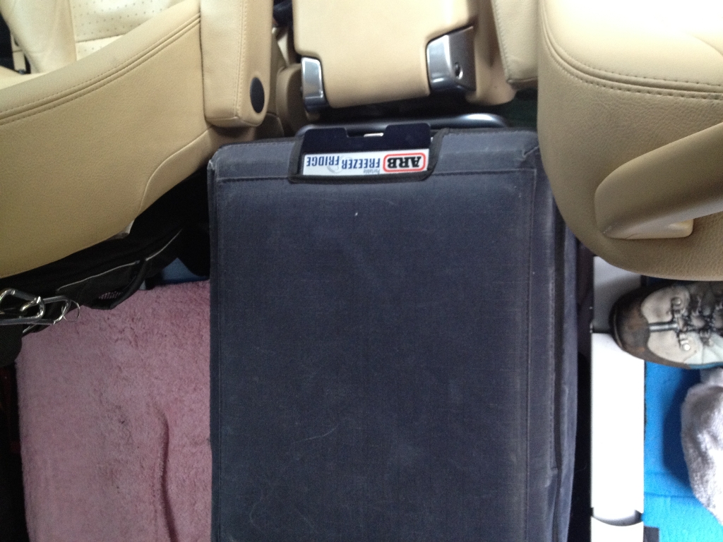

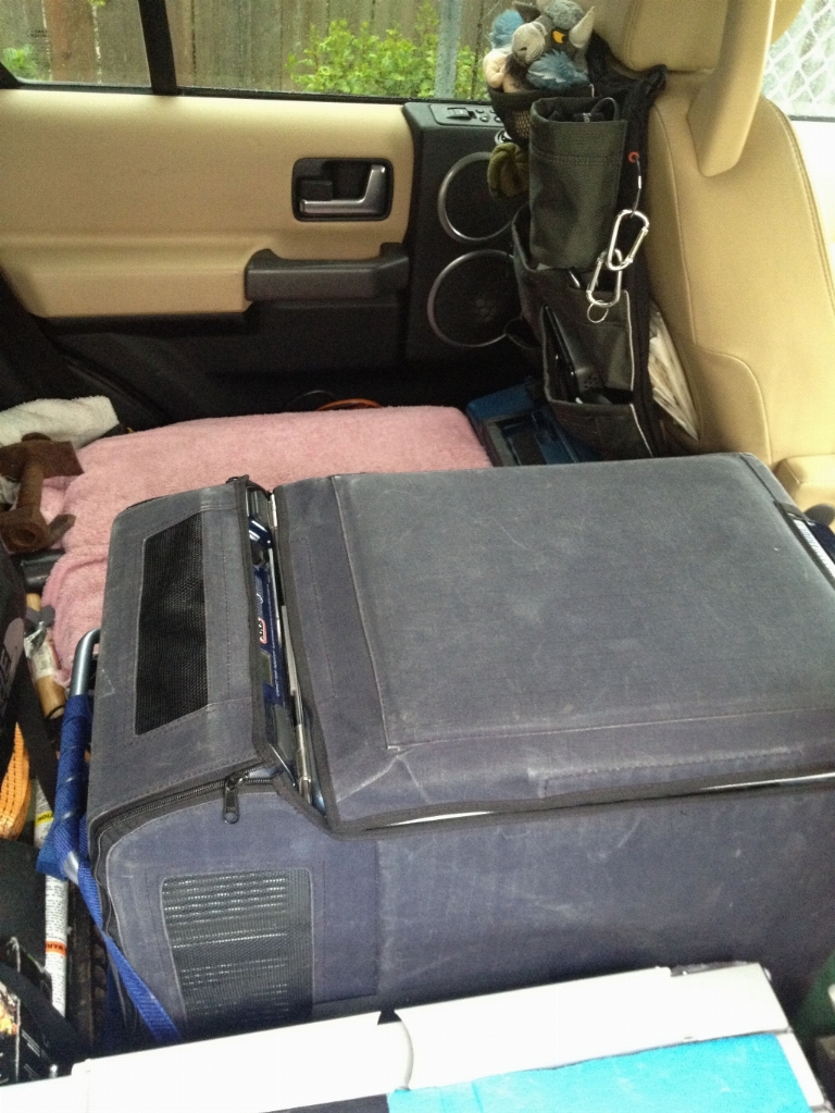

Seats down and covered but you can see how perfectly the ARB freezer/fridge just happens to fit:
There would be more clearance between front handle and center console however with the items in the 3rd row footwell, mine has to be snug there.
I'm not going to pull this thing out right now but I felt under it and around the rear edge of the 2nd row seats there are a couple open spots in the carpet. I just put a towel under mine which covers the holes and catches any debris so it's super easy to clean periodically. Basically the 2nd and 3rd row flooring/foot well areas are either covered by the Land Rover rubber mats or a towel tucked under them to keep the carpet nice long term.
