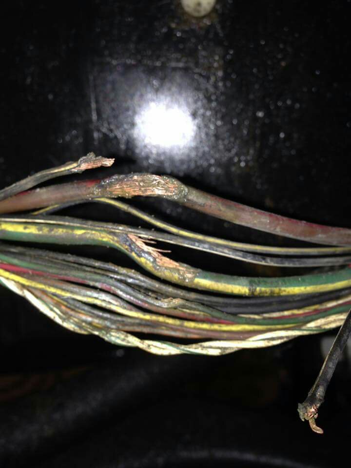

So as some can recall my numerous post about electrical issues with my LR4.
I had narrowed it down to a CAN Network failure. Given the faults, and their commonality it was the only logical explanation.
I started to look for a indication of a broken harness, failed connector, or a bad module.
Low and behold; harness in the left front wheel well is dangling.
Upon further investigation, I can see broken wires in the harness.
I must have left the harness unattached last time I did brakes (October2016), as I have to move it to remove the wheel well liner to replace the pad wear sensor. The tire has been having a go at it since then. Now we have reach the culmination of failure.
I am hoping it is fixable, and I do not have to replace the entire harness.
Otherwise it will be an expensive mistake on my part, and probable a few nights on the couch, as my wife will not be happy.

I was a "professional" mechanic for over 7 years (Jaguar and Land Rover Certified, hence the user name ;)). That's why this is so hard to come to terms with. I'll blame it on lack of practice for now.
I have saved a ton over the years doing my own work, also was sure this was the problem prior to sending it to the dealer. But between the 4ft of snow we got this week, and lack of time. I couldn't perform the repair myself.
