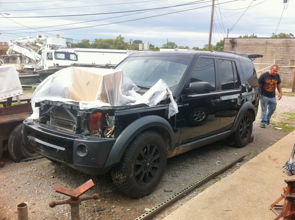

FIXED! well, for now... It would seem that when I installed the rods one of the did not get seated all the way on. When I tested it out the lr3 it raised up like normal but one of the rods slipped off without my knowledge. I couldn't see this because the air bag leak caused the vehicle to lower on its stoppers. Not until I took the tires off to put back on the stock rods did I notice my error... With this said the air pump was very slow to raise it but i'm going to blame it sitting for so long and being so deflated. I am however going to still take it in under warranty to get that leak fixed and the compressor looked at before re-installing the Johnson rods. Thanks so much for your help everyone and I'll be posting pics of my custom hood, side exhaust, roof rack, headlamps, grill and paint job soon!
