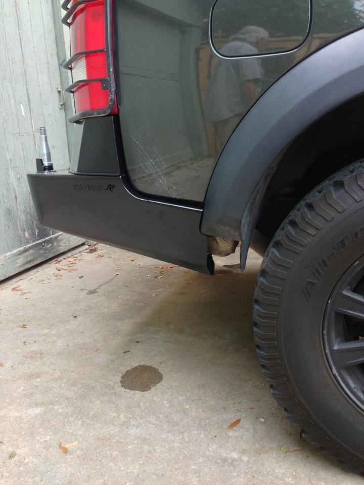

I ordered a Kaymar rear bumper today and I'm already getting anxious about installing it. Someone mentioned that I should order a Set of Range Rover rear mudflaps to close the gap at the rear wheels. I guess that in Australia, all D4s come with flaps and thus it's not a problem. Does anyone know anything about this? Attached is a picture of the gap on another LR4. Not mine.

No, it doesn't appear tough at all, but I'm planning a full day for it. Probably wont take all day, but I'm a planner. I was going to wait until until the install, but the Kaymar has a few caveates that you should know. First, whether right or left, the tire will cover your tail light. Kaymar includes new tail lights on the bumper to fix this, but a few folks have taken the carrier bracket and had it extended 4-6" moving the tire closer to the center. This will prevent you from being able to add a second tire on the other side, but its what I'm planning to do. Second, its made in australia, and from what I understand, the aussie D4 comes with mud flaps. Once you put the bumper on, there is a gap at your wheel well that needs closing. Appears the only viable solution is a set of rear mud flaps. I have them in the garage and I'll confirm all of this once I get to the install. I'm hoping to do it around june 1st or 8th. We'll see.

Thanks for additional information. I think I would definitely move the tire closer to the center since I would only mount one tire. I can't wait to hear more about the install and see the finished results.
