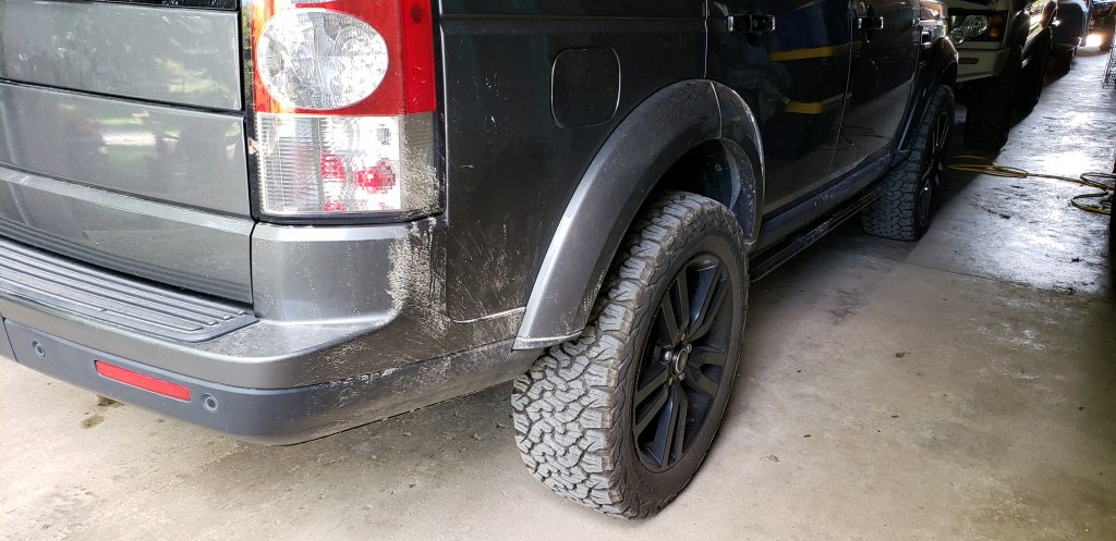

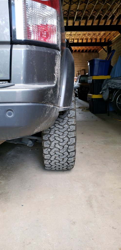

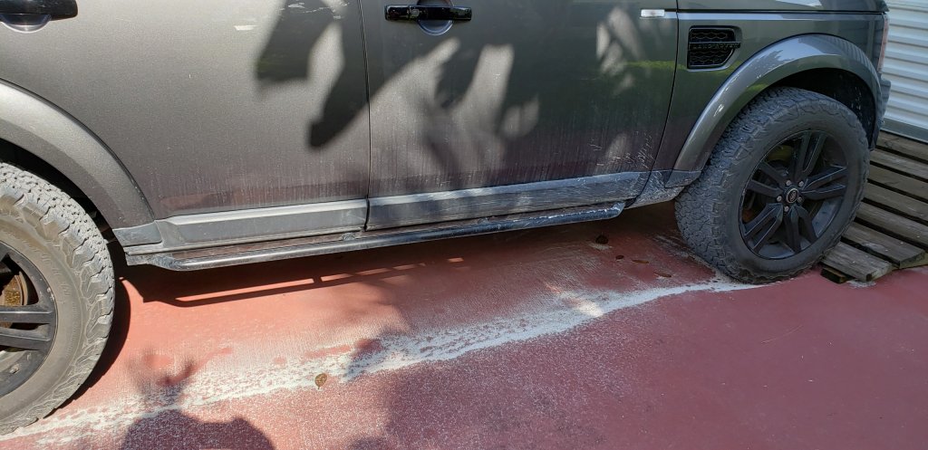

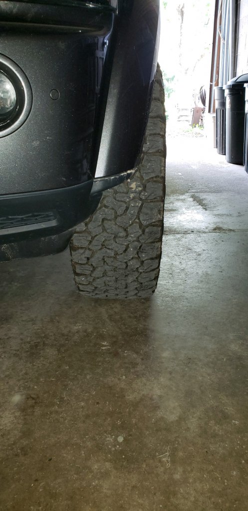

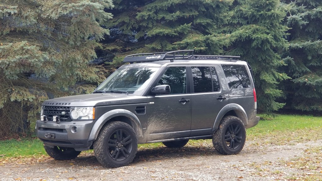

I've had a small rub driver's side, at near full lock. corrected with an alignment. i want to stress, even slightly out of alignment and you will get a small rub. If the rig is properly aligned, you get zero rub at normal height. if you drop the rig down to access height, you will get rub when turning. Other than that, issue, now resolved, I like this setup and ride better than the stock LR4. With the spacers, larger tires, slight lift, you get a very minimally stiffer ride. I have a 2nd 2013 LR4 LUX, my wife's, without the lift, tires, and spacers, so I can directly compare them.

yes, running 1" spacers and no issue running normal height, no rub at all if properly aligned. If the alignment if off, even slightly, you will have rub either driver side or passenger side, depending on which way the alignment is off. it will rub without spacers.
