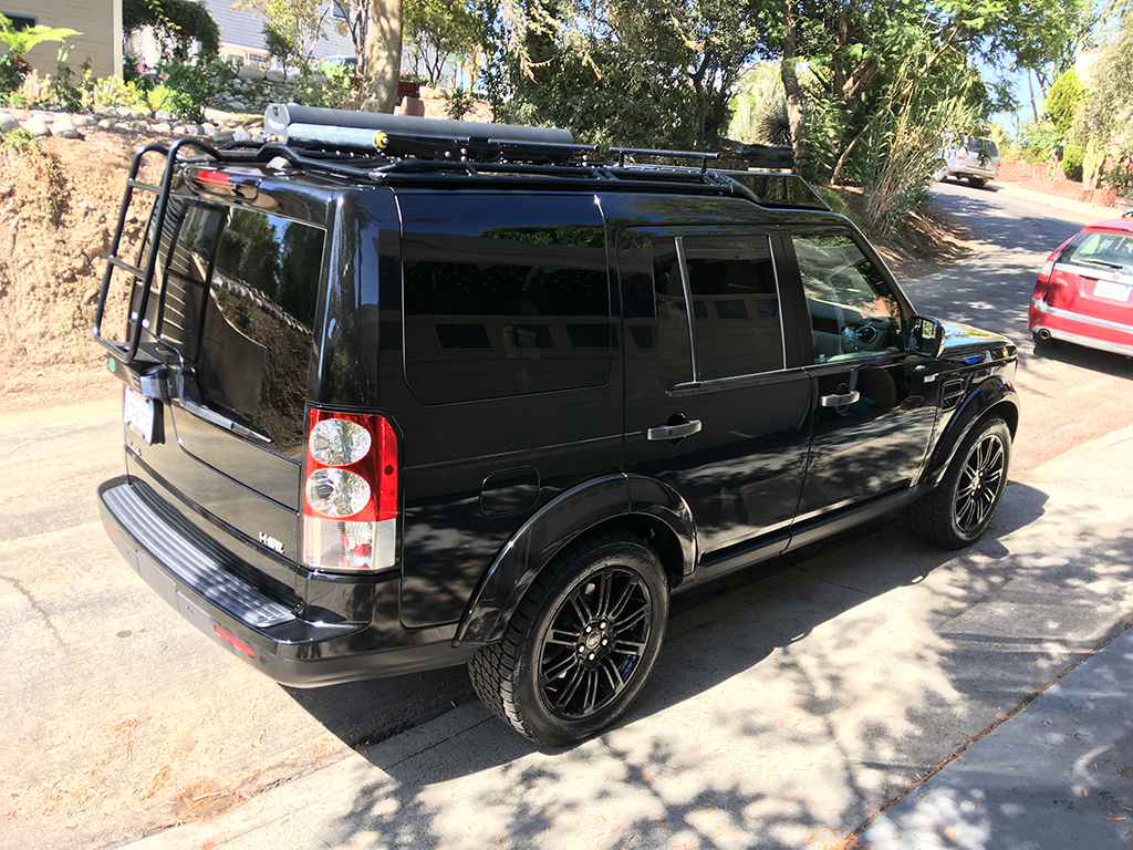

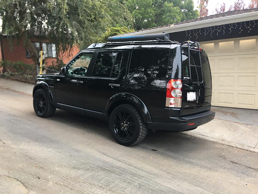

Well, got them on after all. When I took it down to my Landy Guy, he said, since the car was on a lift and had not been Locked into access mode, the suspension kept reaching, making it hard for the tech to get a very heavy wheel flush with the hub (sound familiar). I have to say I love the way this set up feels for daily driving, camp/light forest trails etc. Road response/handling is much improved, and still delivers that classic LR cloud ride. Next up, order a set of 18 compos, Install dual battery sys and add a fridge of course. Aux camp lights and rear tactical bumper with swing away might have to be in next years budget, you definitely feel the wallet drain with these beasts, but I just love this truck! HSE with HD package front and rear lockers, bought it last year with 32k on it.

I have the same 20" tires and rims as Kelly Barrie and I find them to be quite quiet and comfortable on and off road.
How do you like that roof top shower? Does the sun warm up the water well?

Roof top Shower is amazing. I highly recommend the shower attachment which I find invaluable especially after hitting a remote beach or lake with the kids. I'm in SoCal, so on the really hot days the water temp can get too hot, so I either park in shade or run my Hilleburg awing over it.
