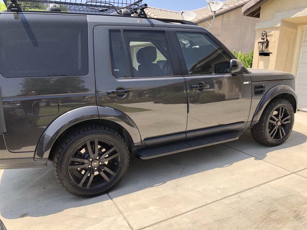

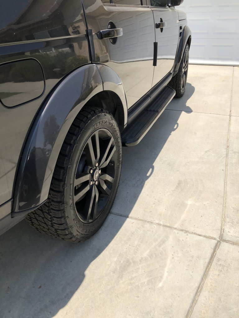

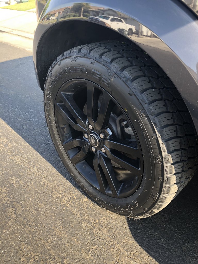

I'm hoping the knowledge base here can help shed some light on a mysterious tire fitment issue. After reading many, many tire threads, I decided to run nittro terra grapplers 265/50/20 on 20" oem ten spoke rims (2012 LR4 HSE). So all excited, I took the rims and tires to get fitted, rears went on fine, but much to my surprise the front tires would bump into there upper ball joint preventing a flush mount. Suffice enough to say, I had to give up, load the wheels back into the truck and leave feeling pretty defeated. As I drove away, I noticed that the suspension had been set to off road height, not sure if this was an accident on the techs part, but I didn't have time to return that day and ask some more questions. Any ideas, thoughts on what the problem might be, shouldn't the tires fit in off road mode anyway? Any help would be greatly appreciated.
1,867
Putting the suspension on off-road height is procedure when lifting all 4 off the ground. Regardless, the tire shouldn't ever touch no matter what height the suspension is at. I'm not sure about that size tire, though; I have no knowledge of the 20-inch wheel issues.
Are the 20 inch wheels you have from an LR4?
Kelly Barrie
Dec 11, 2017
28
26
Los Angeles
Thanks for getting back, Yes, the rims are factory rims 20 x 8.5. So many people have confirmed this tire size and wheel dimension on their rig that I was surprised it didn't fit. I did have another thought, the front rotors are aftermarket, could this affect anything? Again, I'm assuming since it's a high quality aftermarket product the rotor specs need to be the same, and I see no depth difference when inspecting the lug nuts.
1,867
I doubt the rotors have anything to do with it. They'd have to be a lot thinner in the hub portion to make that much difference. What brand are the rotors?
