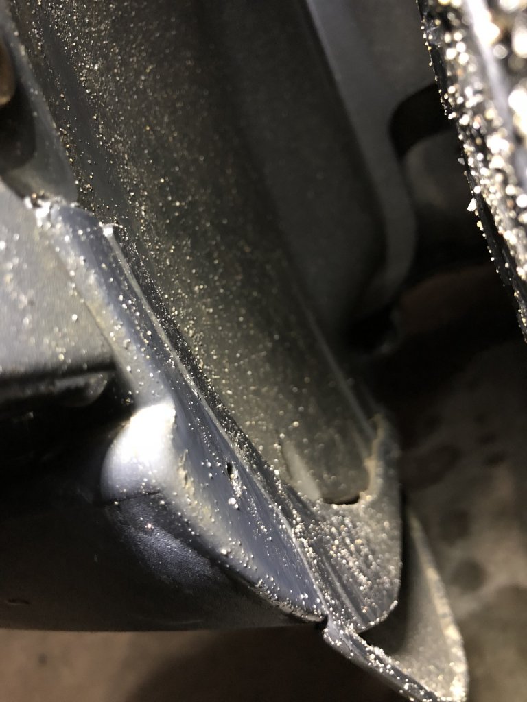

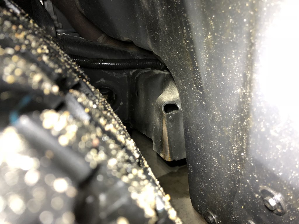

Where exactly are they rubbing? The frame? Tks
It rubs on the front fender liner screw, as you can see in the picture I have removed that screw. Also the front corner frame.

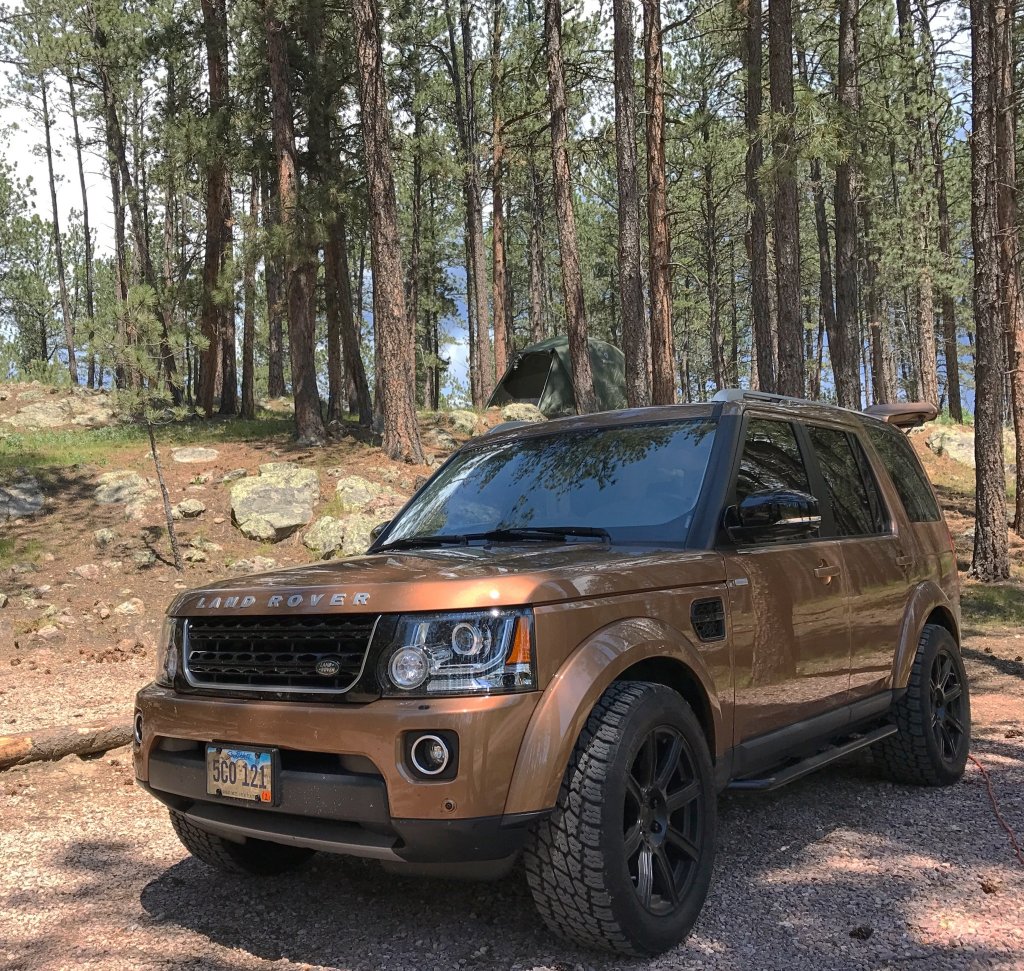

285/50/20 G2s. They do rub slightly at close to full lock. Redbourn wilks wheels.
Beautiful Truck!
Are the tires flush or less with the body panels? My concern would be kicking up mud and grime onto the sides so easily.
I used to have the mudflaps but they all got ripped off on the trails. This truck should come with flexible flaps not rigid ones.

Thanks! They are flush and should tuck up under the fenders. I haven’t been at full flex yet to test that. This setup will throw road grime on the side of your vehicle but the rock sliders help limit some of that.

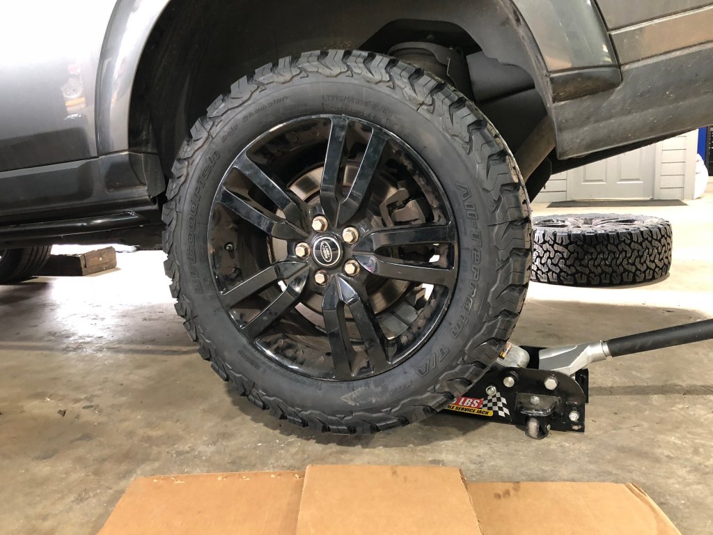

View attachment 7827 2013 LR4 HSE LUX, Just installed 275/55/R20 BFG KO2's, will post on any rub issues
OK. I took the plunge and went with the nittos on 265 50 20. They look great IMO. We tried to mount the BF's in 275 55 20 and they just got stuck in the frame. Not sure if its my wheel but they were not just rubbing. They got stuck really bad. Not safe at all.

very nice. where you get them? 9.5 or 10in wide? I want some.
Wheels: Redbourne Wilks 20x9.5” ET32. Got the whole setup(4): wheels,tires, tpms(still don’t work), and lugs for $2231 from discount tire direct.
