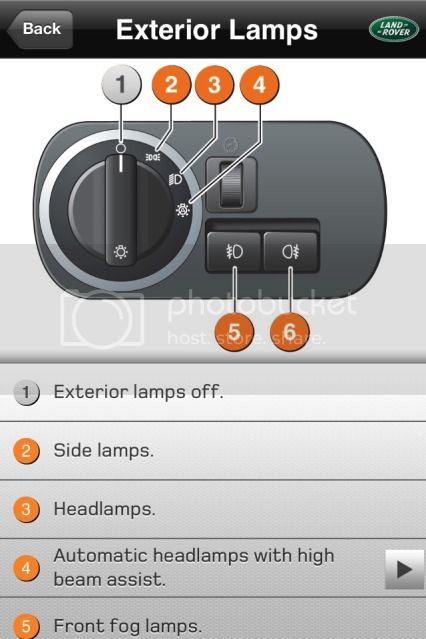

Here is a schematic, even thought it says "side lamps", it also turns on the LED signature lights (position #2 here):
Give it another try and let me know if it works.
Regards, David
