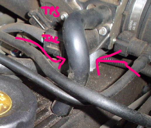

Can anyone tell me where I might find the IAC/stepper motor? This is for a 96 Disco SD 4.0 V8
Thanks
Jim

Is that it in one of the pictures in the pink square?
I'm sorry I don't mean to sound like an idiot or be a pest, but for the life of me I cannot determine from that thread which one the IAC is.

sorry.... yes that is the stepper motor, unless I have completly lost it..... that is possible you know

"Also called the "Idle bypass valve" and "Idle air control motor". This motor is located on the upper plenum of your rover and allows idle air to flow around the throttle plate when its closed."
This is a better pic. Hope it helps. IAC is labeled in the attached pic.

Sweet. I actually just started taking things apart randomly last night, and cleaning them. I took off the tps and (what I now know to be the IAC) - and cleaded them up. It worked! haha. when the rover started up I actually Jumped for joy and let out a VERY LOUD, Bo Duke style "yeee-ha!" haha I'm such a hick;
