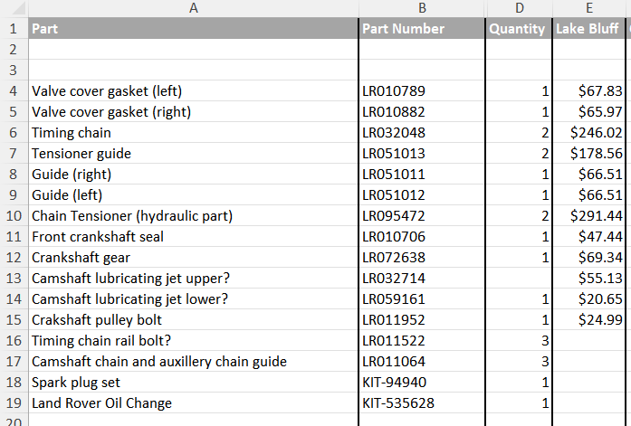

Last night I removed the coil connectors and bank 1 (passenger side in the US) coils and also got the injectors unplugged. I tried to remove the fuel rail but it wasn't having any of it so I gave up and started looking at YouTube! It looks like some leverage might be the best way to go (and also some penetrating oil); need to figure this one out if anyone has any ideas? I also did some more cleanup of the compoents I've already removed (throttle body), intake manifold, etc. Progress albeit slow... I also ordered a bunch or parts for the timing chain; here's a partial list:

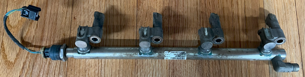

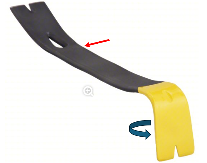

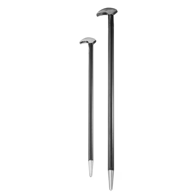

Thanks - I got both fuel rails out this evening, on the driver side I used the webbed area that holds the bolt for the coil but struggled with injector number 8 (the one closest to the driver); in the end I wrapped a piece of rope around the inlet portion of the rail (for injector 8) and used that to pull! The passenger side I used a pry bar that's about 1.5" wide and pulled it laterally rather than back and forth like you usually would, I used this rotational motion to leverage the rail out:

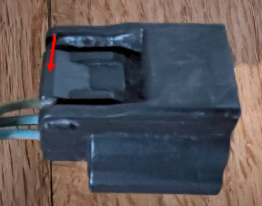

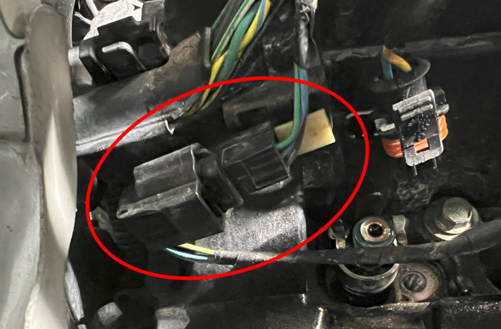

The most interesting part of the evening was disconnecting the electrical connector on the passenger side fuel rail, here it is in situ:
Without knowing how to disconnect it I struggled for quite a long time; the secret is to push at the very back of the connector, so here (see the red arrow):
and then slide it off. Here it is in relation to the fuel rail (this connects to the same wiring loom as the coils and injectors):
